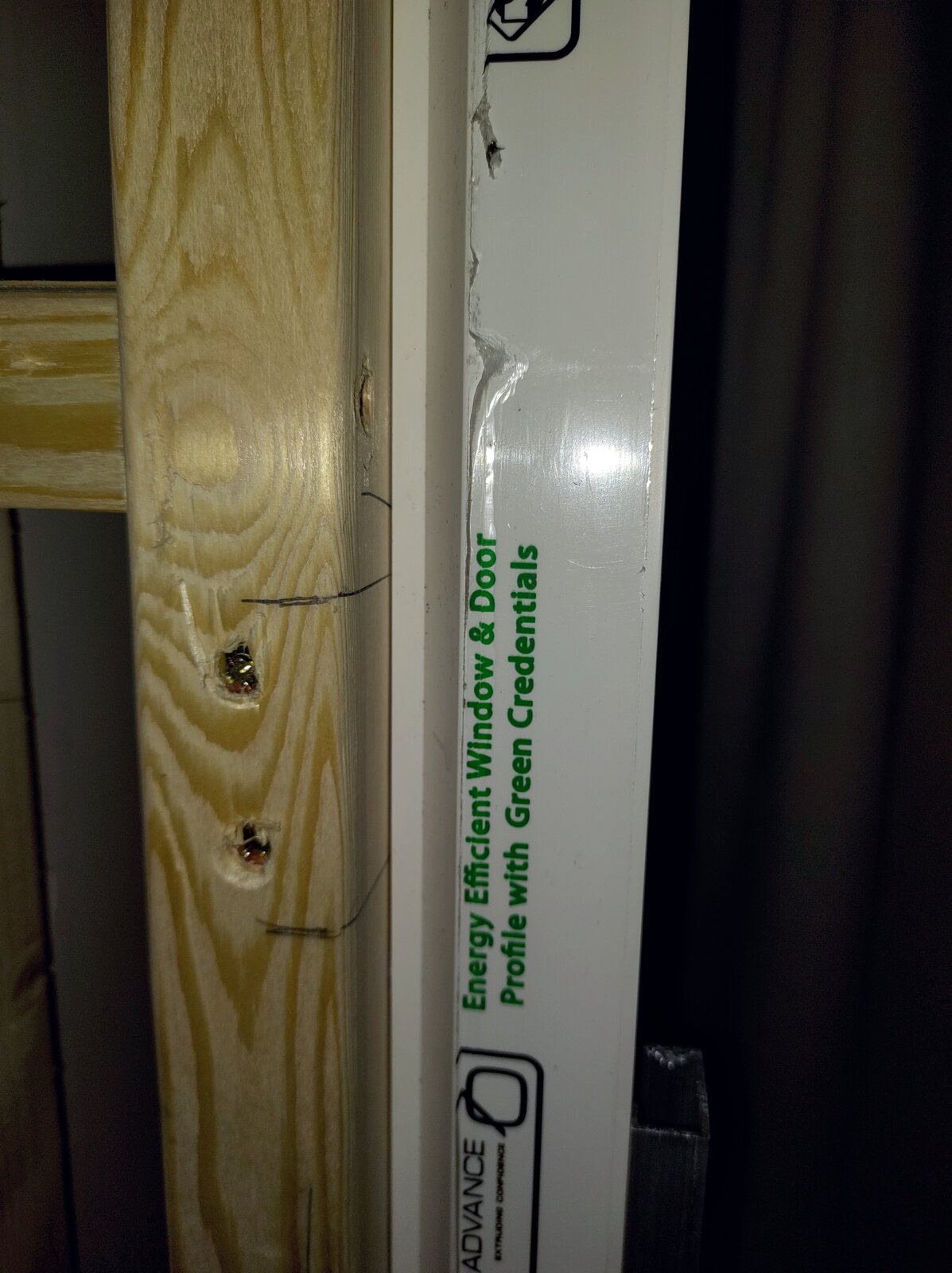

I'm fitting a patio door made from Selecta profiles. I'm wondering why the outside of the frame sections slopes inwards at the edge. What I mean is the outside of the frame, all four sections, look like in the photo attached.
Can anyone tell me why it's made with that shape profile? Why is the profile not like a window and just a box section?
Is it meant to have trims fitted over the gulley that is created when the door has been fitted?

I'm not totally sure what in the picture you consider untoward or which part of the frame I'm looking at. I have actually fitted one of these but I don't remember many specifics except having to prise some bits out to avoid having screwheads visible.
The picture is part of the left jamb viewed from the outside. Where it contacts the wood frame it's chamfered about 45 degrees. The frame is that profile on all four pieces. The inside of the frame doesn't have that chamfer and I'm wondering what is it there for? As the door is between two rooms I'll be plaster boarding up to the frame and that chamfer is going to make it harder.

I'm pretty certain it's so you can link them to other frames like windows with frame couplers say like if building a conservatory where standard window frames are 70mm wide where as a patio will be at least 100mm if its an inline/bypass slider so they taper the frame down to 70mm
Ah, the shadow in the pic was tricking my eye. Yes I do actually remember that now, it was a bit unwelcome because the brickwork was uneven and it made it all but impossible to put any trim over the gap so I ended up using trowel mastic :mrgreen:
As for the purpose, I'd say it's just to make the door look less chunky
Yeah that makes sense. The frame is 88mm and that chamfer is 18mm so reduces it to 70mm.
As Cackat says it makes it look less bulky but, I think it looks a bit crud and creates extra problems for me. If I'd realised it was like that before buying I'd have bought elsewhere. Ah well you live and learn. Thanks for the replies Crank and Cackat.
I think all pvc inline sliders are chamfered, every type I've fitted have been and I started fitting these in the late 90s

Ah well that's cheered me up. If they're all the same then buying elsewhere I'd still have the problem. I'll likely put 25mm D mouldings between the frame and the plasterboard and cover the chamfer.
