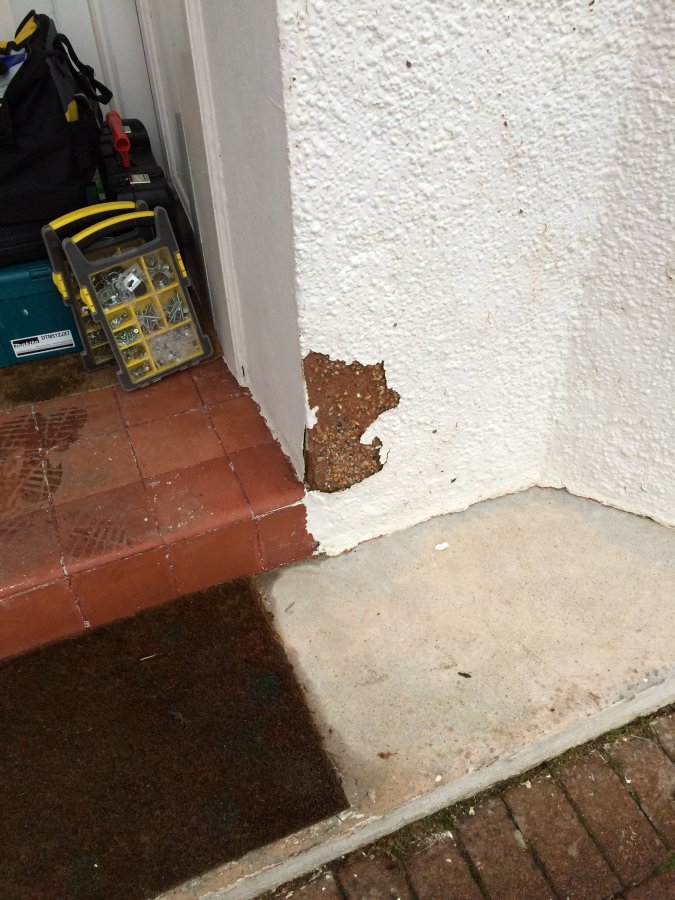

Hi all,
I eventually will be re-rendering my property once I have an extension done, roof and soffits replaced as then and only then does it make sense to get the rendering done.
Anyways I have an unsightly bit at the front of the house.
A combination of age, weather, deteriorated paint coat and my wife hitting it with my sons buggy has resulted in this unsightly section.
I wish to patch repair it as anything will look better.
How do I go about this?
Would it be better getting a pro in to do it?
Do I just need to remove loose paint and re-paint?
Should I chip back to bare brick and re-do it? Is this something I could do myself as a keen DIYer?
Regards, Gordon
That's just paint that's come off the dash is still intact
I have had a closer look and the dash is not intact and I feel best cold chiselled back to bare brick and re-done.
Is there a ready-mixed product I can buy from one of the mainstream DIY stores like B&Q / Screwfix to do this?
I would call that pretty much intact, you have lost a few chippings but, it's just not worth the effort of doing anything other than painting it.
Patching it is likely to result in a more obvious repair, for something so small it's just not worth the bother, especially if your going to be rendering the property in the future.
Just give it a lick of paint and no one will even notice.
As the guys have said, i'd leave it alone. If you start using a chisel on that, you'll regret it. I'd just "carefully" remove any loose flaky paint, trimming around it first with a Stanley knife, then give it a few coats of external paint.
