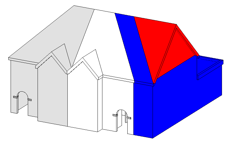

Hi all, hoping someone may be able to provide some insight into what roof enlargements you can make under Permitted Development Class B.
I am particularly interested in condition B.2(b)(ii) which states:
"other than in the case of an enlargement which joins the original roof to the roof of a rear or side extension, no part of the enlargement extends beyond the outside face of any external wall of the original dwellinghouse"
Does this prevent any additions being made (e.g. a dormer) above a previous extension, therefore roof enlargements can only be made above the original dwelling?

I'm struggling to fully appreciate what is allowed based on above, i.e. could a hip to gable be undertaken above an existing side extension if it joins onto the original roof?
Any thoughts or examples would be appreciated.

Generally there is no permitted development allowed to extend or enlarge a previous new extension or enlargement. (Unless there is some unused PD allowance such as enlarging an extension from 2m deep to 3m and still be within PD limits).
I cannot see how you would get a hip to gable conversion on a previous side extension roof under PD but I might be wrong.
Can you make a 3D sketch of the before and after of what you want to do?

I had thought that this might be the case based on condition B.2(b)(ii), though was interested how others interpreted this condition.
This is a rough sketch of the arrangement.
The blue section is a previous extension and the red section is the potential hip to gable conversion we're considering.
If that sketch is dimensionally accurate (or close enough) can you tell us what the original volume of the roof space is, how much volume the blue part added and how much volume the red part then adds?
