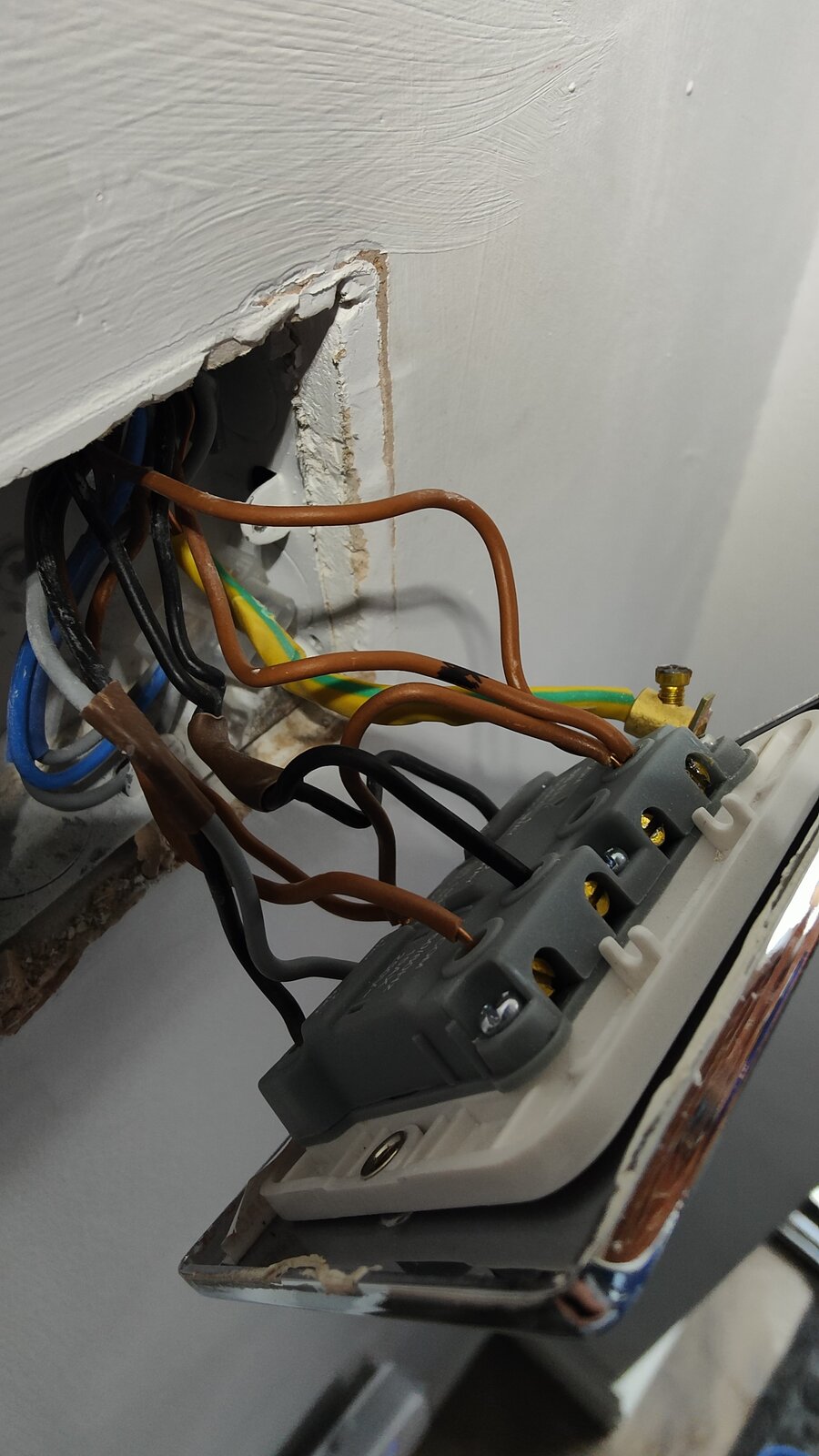

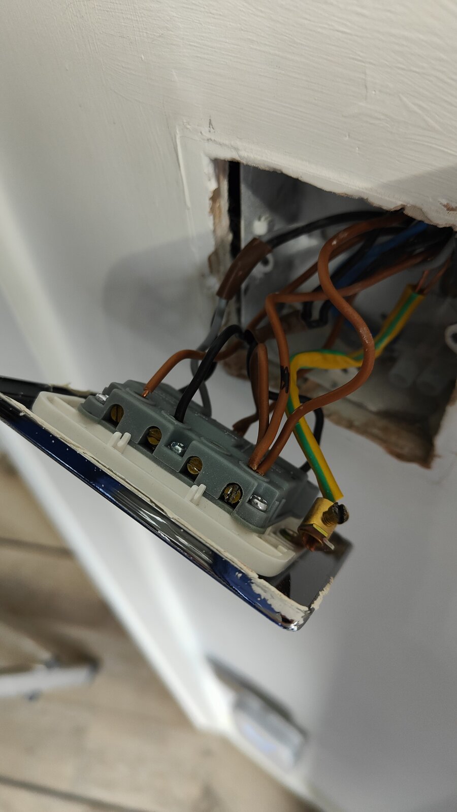

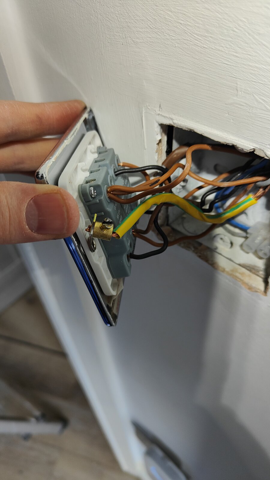

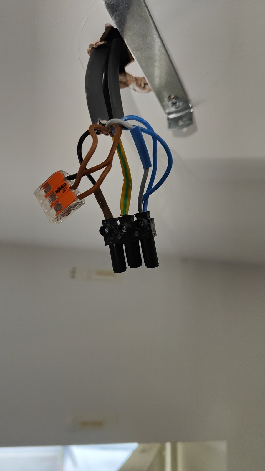

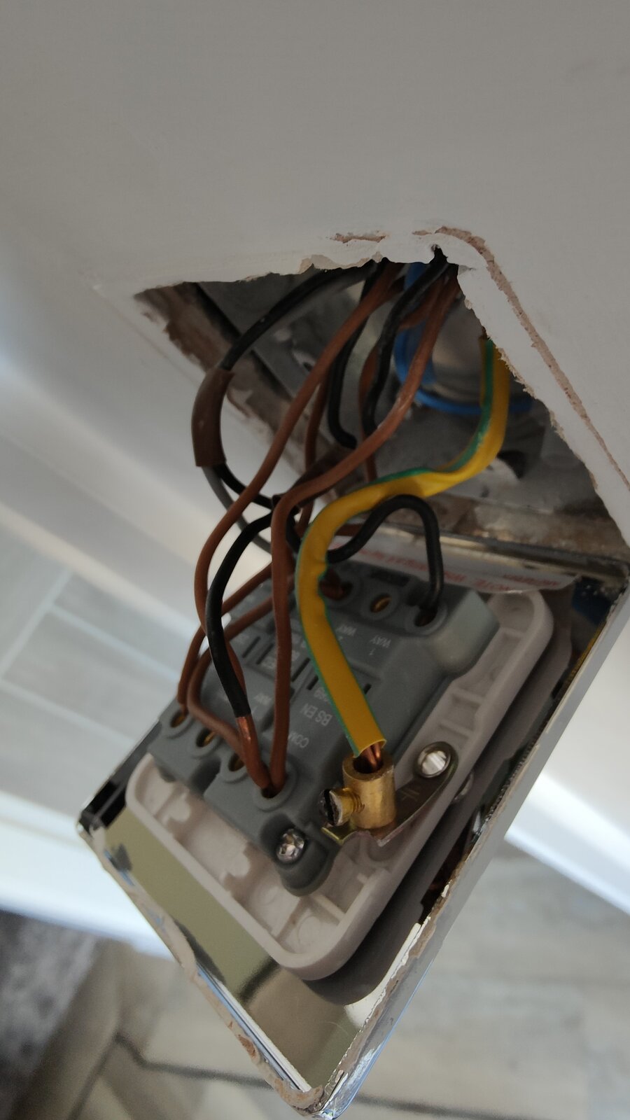

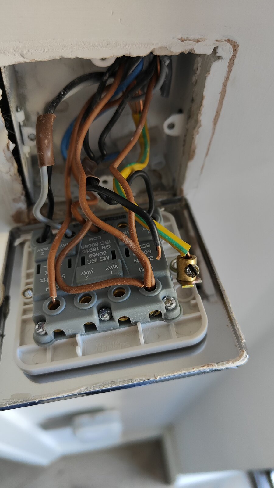

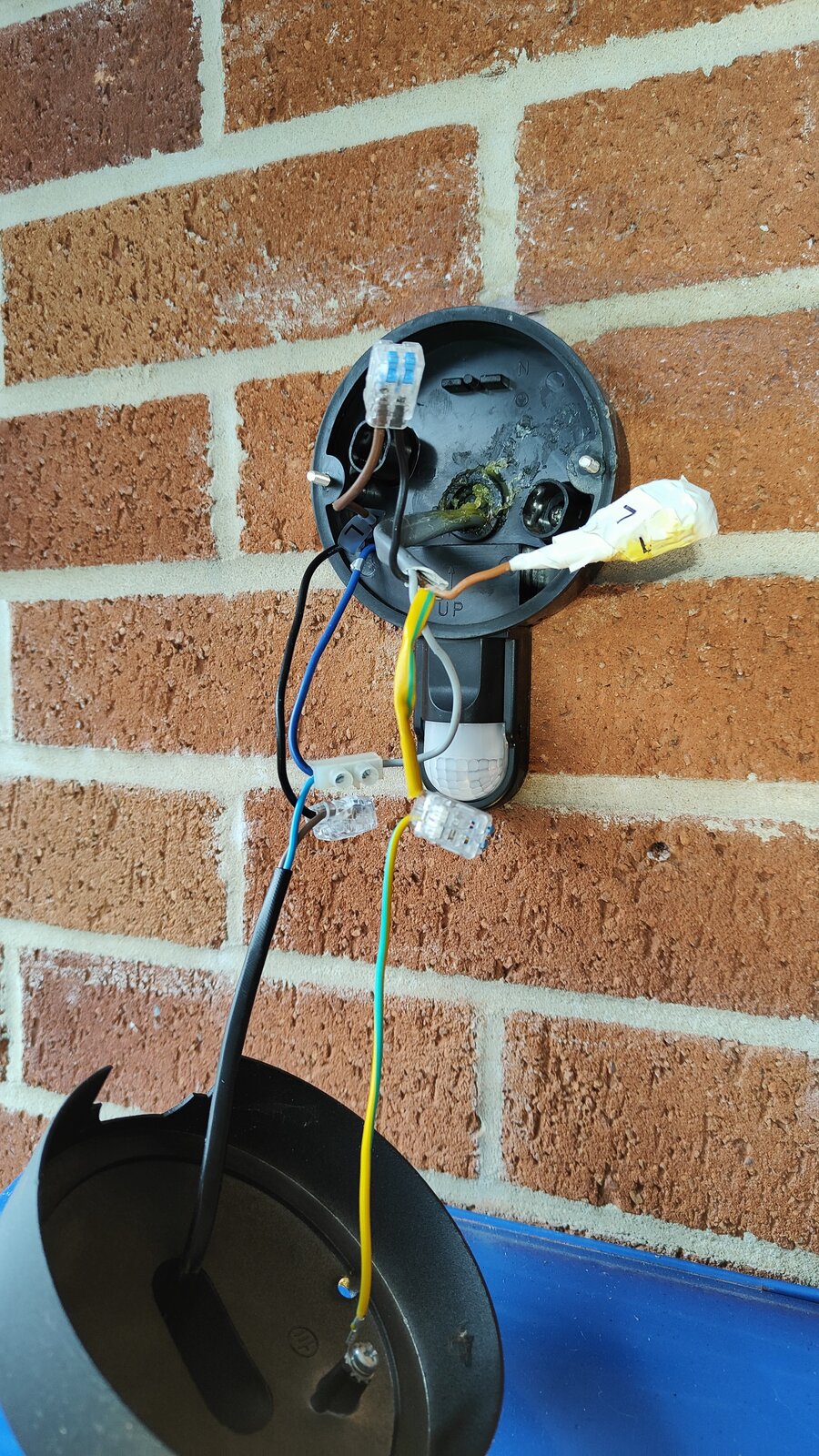

Hi all..
Replaced old light with new.. and the new only needs a live and neutral.
So there is a spare cable which is live..
I can't for the life of me find where it's connected! Driving me mad! Can you help?
I just want to disconnect it.
It is the far right switch in the pictures

You don't necessarily have to disconnect it ,just put it in an insulated terminal block ,or wago, and leave it in the fittings base. There is a black insulated wire that is not connected to the switch ,in your pics. Has it come loose / out of a terminal ? It shouldn't be left loose like that.
Yes came loose.. I've put that back in for the lights in the hall.
That PIR cable is getting converted to a 1way switch for spots. And the PIR getting moved round the corner. I can leave it in a wago but it's driving me mad not knowing where it's fed from
