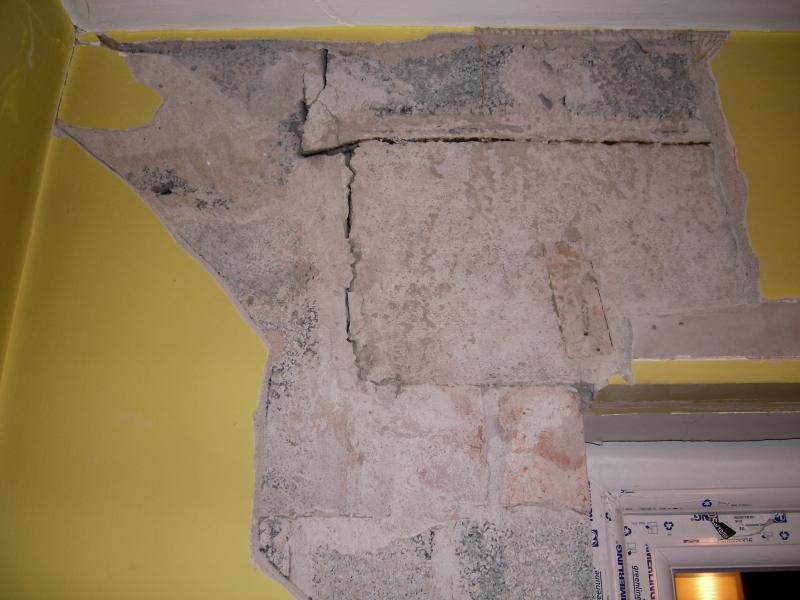

Started first room....I've used a stanley knife to cut out parts of the cracked areas (as previous suggestions). Most of the areas have complete brick behind. There are two cracks in the mortar where the lintel over the window joins. The LHS is worst - see img.
(The crack is vertical - the horizontal dark area is actually some type of black liner. No sign of any damage at all on the external brick). I'll use the techniques suggested by Richard & Roughcaster when I patch, so think this should sort.

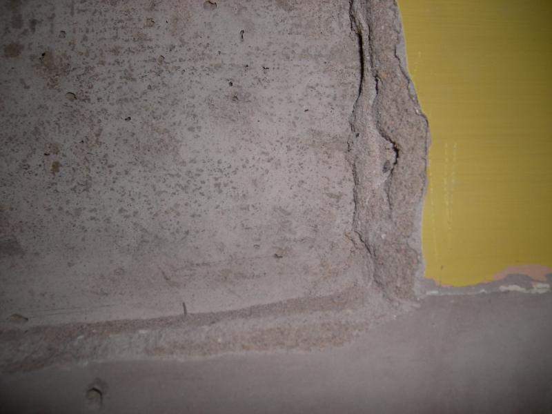

What concerns me most is that where I cut the plaster away, the skim is still hard but the plaster underneath is softer. If for example you run a finger firmly down the plaster broken out it powders to the consistency of what I can best describe as 'granulated sugar'. The edges on show here seem a lot firmer and less weak. Closer view:
In the cracked areas it had lost adhesion to the brick and was easy to prise off with a screw driver.
I don't want to go too far - the patches are starting to get a bit bigger than I would like, but am concerned that I do enough. I guess I would expect plaster 30 years old is not pristine, but clearly don't want to decorate to find in 6 months it needed more. Any advice appreciated.

A lot of old brick walls have that powdery sandy floating coat, although some are worse than others, and you really could go on forever powdering it off.. Wet the areas/edges down with a brush, and seal the edges with PVA and leave it to dry, that'll firm up the powdery edges meantime... When you come to plaster it, give it another PVA, and plaster straight onto it while it is tacky..... You wont need to go and buy a darby just for a couple of patches. Once you've got the wall coated out, a small piece of skirting or similar would be good enough to level off the plaster ready for the float, by working from the hard surfaces surrounding the patches. You'll have a little bit of work to do building up the plaster around the reveal, but just use a small piece of wood as a straight edge to form the corner... I would carefully chisel out the old cement from the cracks in the brickwork, wet down/pva and repoint,then fix your wire lath over the cracks, and then coat out the patch in two stages, if you find it easier that way. I would also take off the small area of painted plaster at the top left of the pic, for all there is,,, and also,,if you don't need it, remove the piece of wood set into the lintel for fixing the old curtain rail. As I said, the PVA will stabilise the edges until you're ready to plaster. You've a fair bit of info in all these posts, so i'm sure you'll manage, if you need any more, just ask. ;)
Roughcaster.
Rough’s spot on, exactly as I would do it. As I said previously, I tend to use render as a base over the mesh particularly in areas where the corners of lintels are involved but I’ve been told it’s actually no better; emotional thing I suppose! Just make sure your extend the mesh lath well beyond the cracks.
After looking at pic number 1 again, I think it might be better to leave the small block of wood in place ( on the lintel), and use it to your advantage as a fixing/nailing point for the wire lath, when covering the cracked (soon to be re-pointed) cement joints. ;)
Roughcaster.
