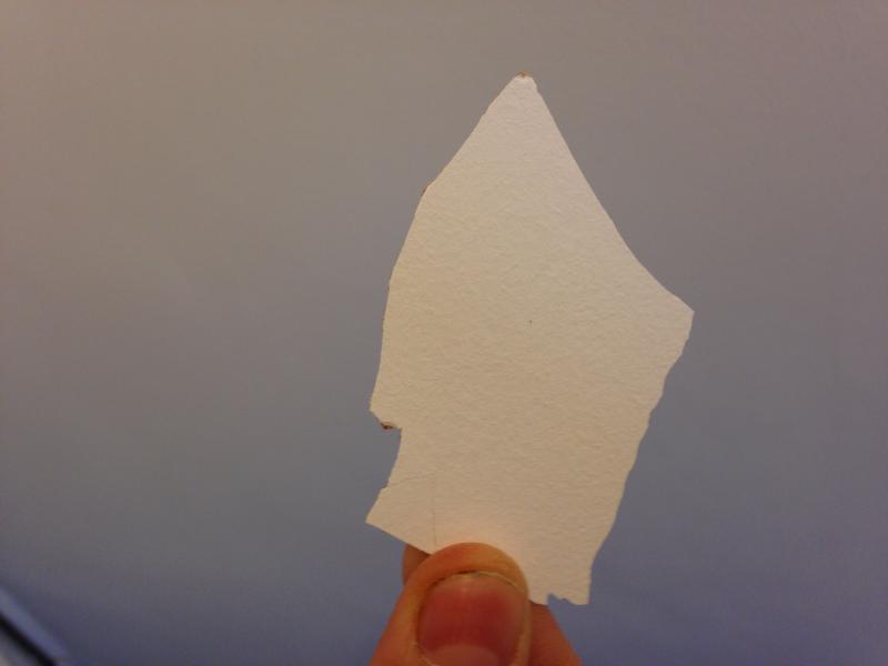

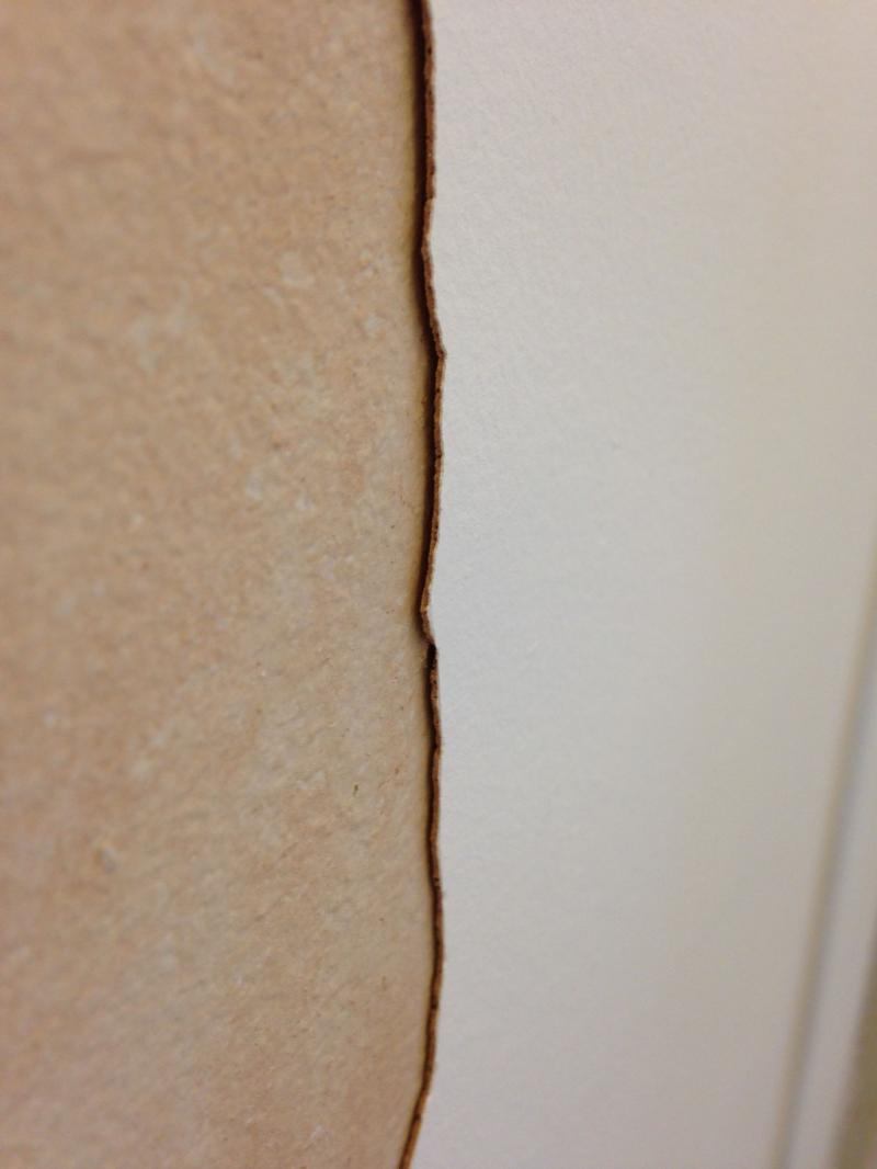

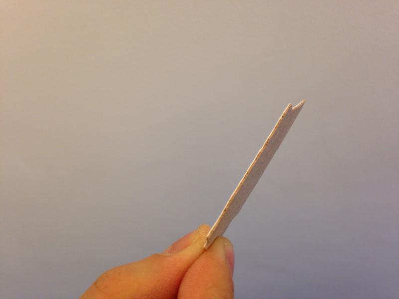

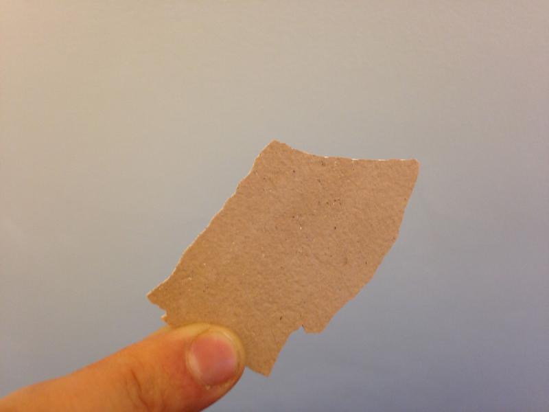

After drying, noticed the paint had areas that were cracked and looked like large air bubbles underneath. When touched, the paint + what appears to be plaster started coming off in large thick flakes (see photos).

From the photos, am I correct in thinking that the plaster is coming off with the paint?
Could I have done something wrong with the painting, or is this a problem with the plastering job, or some other cause? Are there any other causes, e.g. damp, I should eliminate before contacting the plaster?
