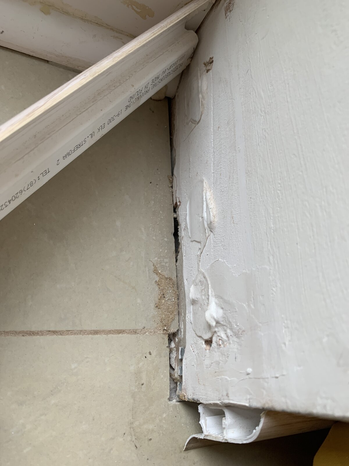

Hi! I have those plastic skirting pieced installed around the house. Unfortunately there are massive gaps underneath so we get a lot of wind near the floor/ bugs getting out from below the floors. I will be taking them out to fill the gaps and reinstalling them once sealed. The question is what can I use to seal them?the one on the photo is small if u compare it to the other ones

Expanding foam done with a gun not a can/straw then cut it back when dry
That’s what I was thinking but I’m not sure if there are any types of foams? Also we have a bit of dump problem, is it still ok to use foam?
If you've a damp problem you don't want to be sealing up gaps, air flow helps with damp albeit not keeping warm

Expanding foam would do it, and stick your skirting boards on at the same time, but you will need a bit of practice with this as the foam will expand as it setting so you need something heavy to hold it in place while it goes off for about 20 mins. It would probably be easier using sticks like sh*t or another polymer type mastic, but some don't like certain types of plastic. My advice if you are using expanding foam for the first time is practice outside and don't try to clean any mess of spillages until it has cured.
If you do use the foam, i would wait until it cures before fixing the skirting back....
One step at a time is my advice..
I’m doing it tomorrow and I will post an update regardless of the results.once the foam is dry I’m going to screw the skirting to the wall with the dog screws( I think that’s what they are called).
If it were me, i would stick the plastic skirting back, unless you already had screw holes in them?
