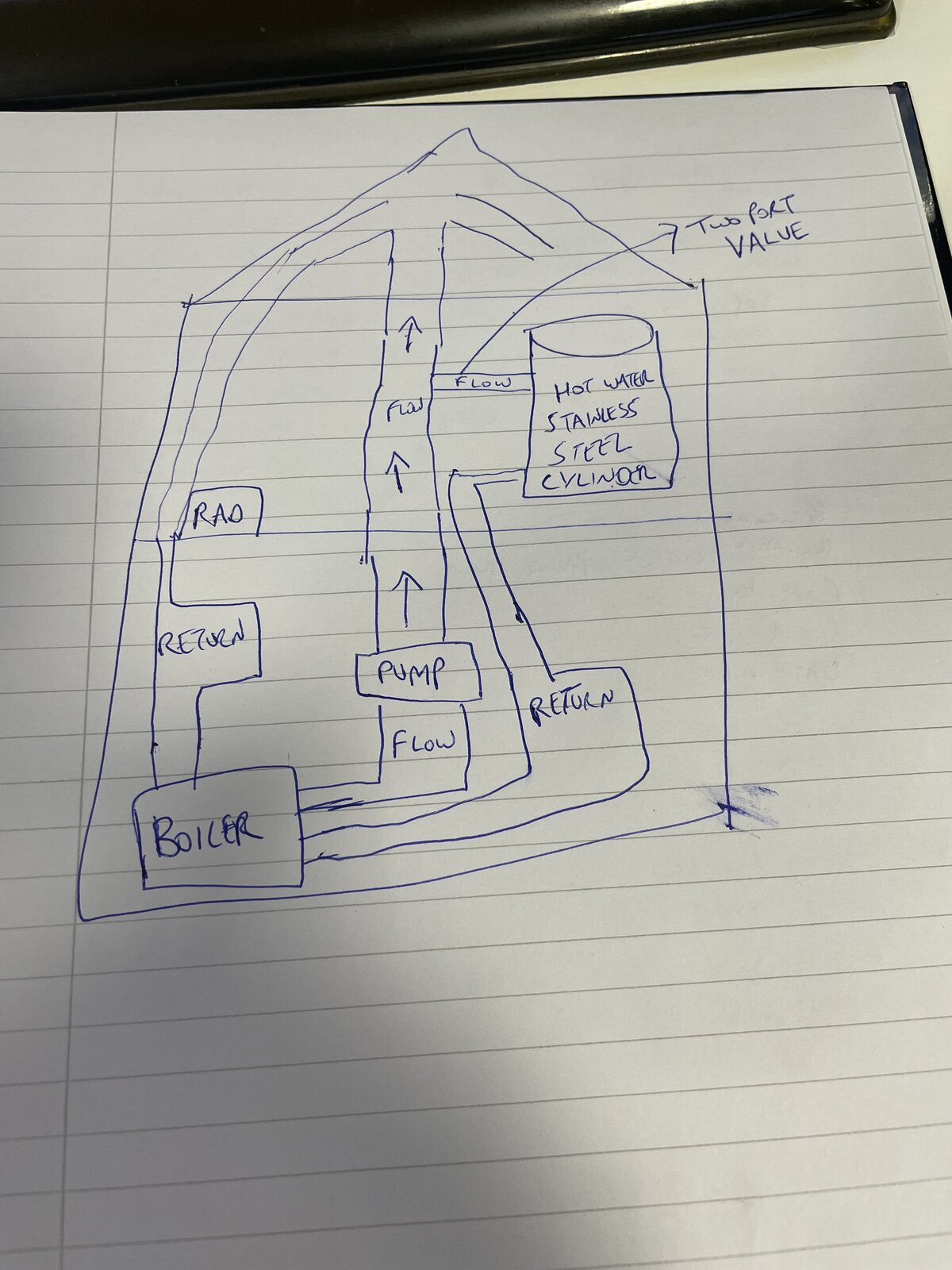

from your drawing it looks like pumped hot water and heating and a one pipe system .
a column rad won’t work fully on a one pipe system.
your boiler of choice can be fitted and will probably work but not really the best way, upgrade the system will be best .

Looks like a one pipe system, but you dont show a vent or header tank, so assume it is closed...there should be an expansion vessel as part of the boiler or on the supply side close to the boiler. Also a pressure release valve and a pressure meter so you can check it, plus a filling loop.
Your hot water supply is seperate...there is a coil in the hot water tank from the boiler, and the tank itself has a seperate cold in and hot out supply which likely has its own much bigger header tank, and is likely gravity fed.
Most systems will have a three port diverter valve so you can have HW, CH or both. Your two port valve (which I suspect either switches to HW when called, or profides either CH or CH and HW) should be relatively simple to upgrade. You do not describec the control system...that would be useful?

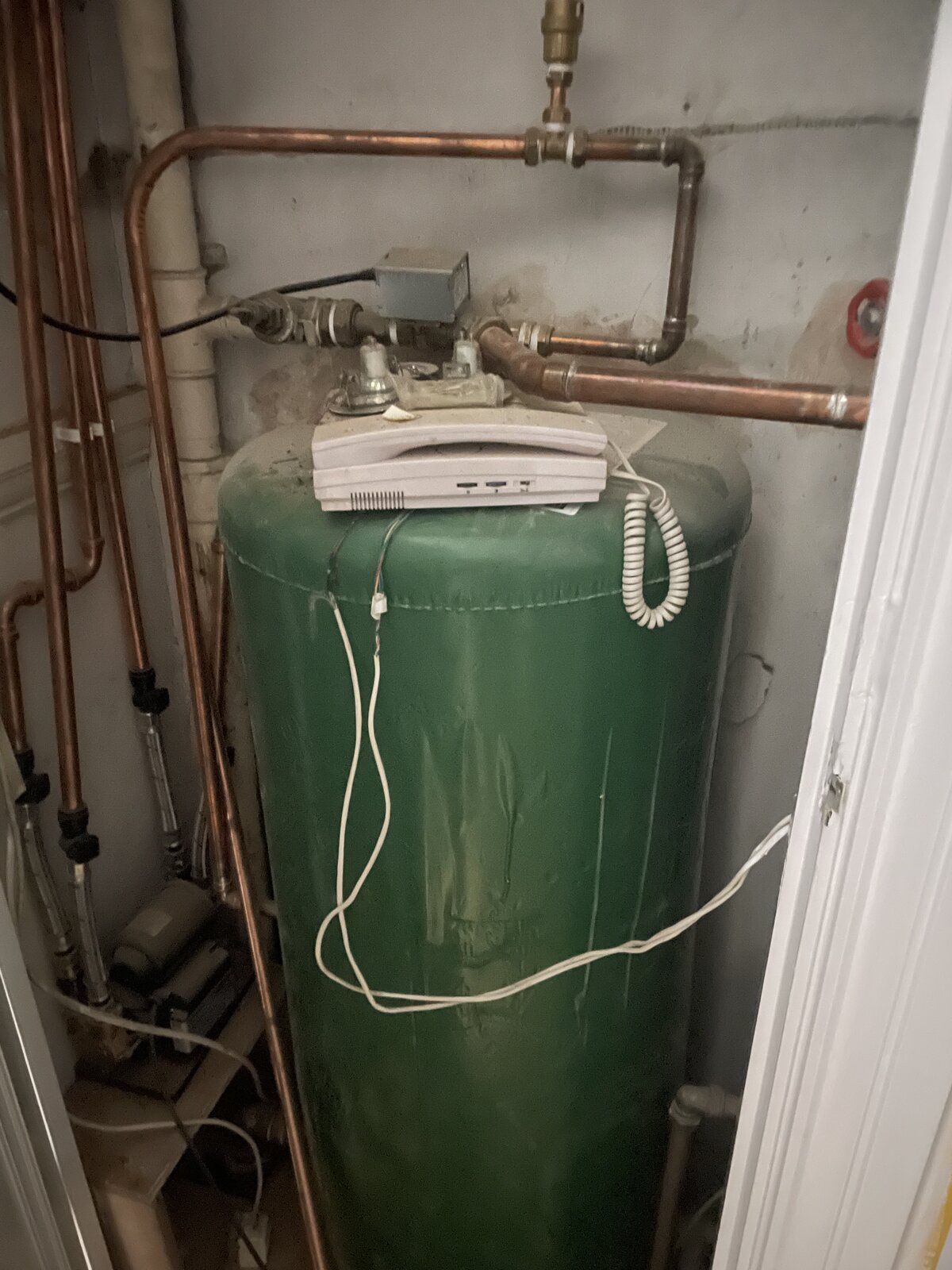

I hope you can see the big fat white flow pipe which then tees into copper for the hot water cylinder
Is my system fully pumped? Partially pumped? Gravity fed?
So HW is gravity fed.

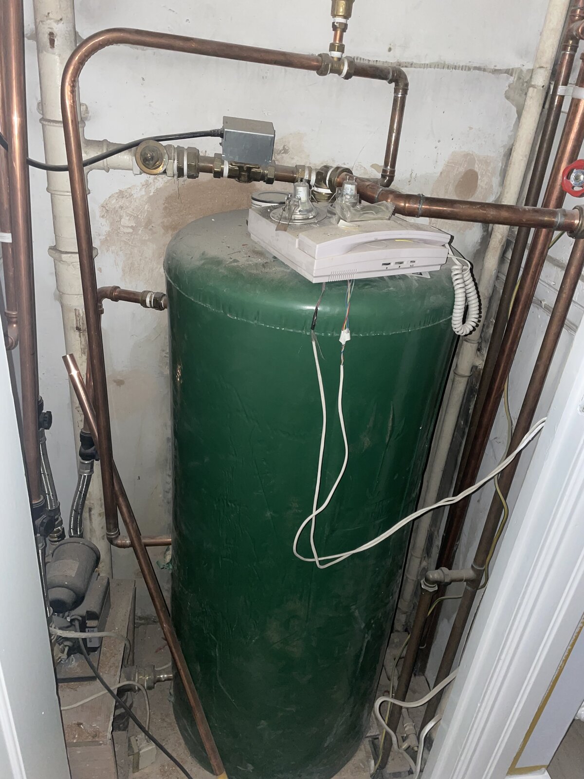

Cannot see why you xannot swap out the valve...I assume it is relatively easy to get to?
Is that how its called? The system is pumped but the HW return is not - I can make modificatoins to the system after the white pipe where the two port valve is
I cannot change the three inch pipework and gave up tryng to get fittings or use a threading machine for that
Ok, so CH control is boiler on or off? Then the valve turns hw on or off. So you have ch or ch+HW..
You could switch to a thre port diverter...but that is pretty serious pipework from the boiler....this a very large older house I assume?

The HW tank coil is part of your "system", the return from that will join the ch system return at some point; this has nothing to do with the HW itself. Hw is simply gravity supply to tank.
Got to say, I agree with your engineers. Ideally, you want a 2 zone heating system (supply goes to two valves, one for upstair and one for down. You then need the upstairs return and downstairs returns to join back as close to boiler as possible), with three way control for HW, CH or both.

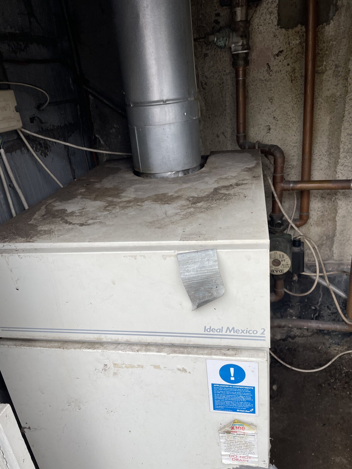

My current boiler which I want to swap out is here
I still dont know if I have a fully pumped system or something else? A lot seems to turn on whether I am fully pumped or not and compliance with regulations etc
Working on a guess...it looks like the supply side splits just after the pump. Do you know what these split into? Upstairs and downstairs rads, or is one to hw tank and one to rads? These look like 28mm...where do they change to old cast iron?
The system is probably pumped CH with gravity HW, certainly going by the size of the HW primary.
Ideally you want someone who is experienced with 1 pipe systems to come and have a look to determine how the system is set up. If it is a 1 pipe and you are not in a position to change to a 2 pipe then it needs careful control and balancing.
