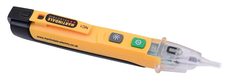

I had the predecessor to this upload_2021-7-24_7-32-38.png the Martindale NC1 which did both solenoid and voltage and found it very good, hope the new owner does, who ever it was.

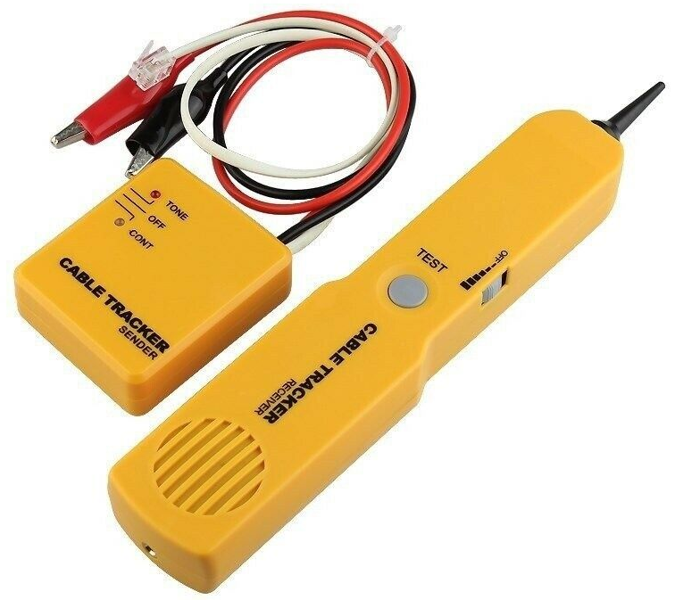

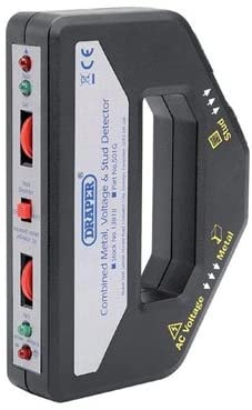

But they are easy damaged, only need a small knock, I bought it to test solenoids the voltage bit was an extra, it does depend how close you are to the live wire, upload_2021-7-24_7-39-44.png these will detect cables buried under the ground to quite a depth, often called cable avoidance tools, and cable trackers upload_2021-7-24_7-44-31.png normally come in two parts sender and receiver, it all depends on what you want it for? I have tried this type upload_2021-7-24_7-47-33.png to be frank not that good, but better than a pen type. I would say likely the two section type upload_2021-7-24_7-44-31.png do work best for finding cable break, but each has its place.
