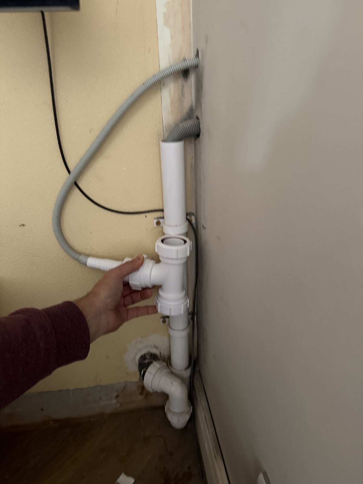

Can anyone solve this one?
I’ve got the washing machine and TD coming out from behind wall to this waste.
I was going to attach the TD to the top and the. I shove the WM pipe down the 90 but is very tight to get round if even possible.
Putting the WM in the top and TD at the 90 might work but the water will pour out the 90’ from the WM unless I seal the TD pipe to it?
Any other ideas?
Thanks.

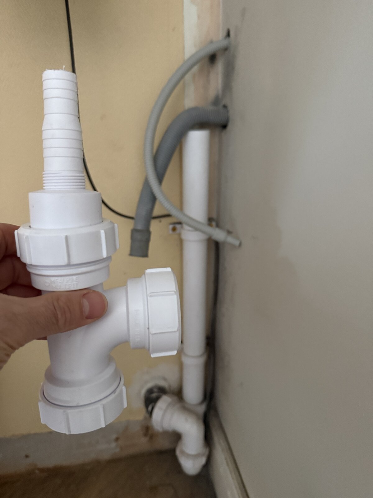

Cut the tee in lower down and use the remaining piece for the TD, or just put a piece extending for the TD?
What sits in beside that, can't you move the stand pipe out a bit? Or take the stand pipe through to where the appliances are?

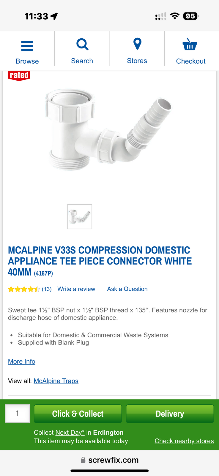

it’s a bit tight for the double attachment mentioned above but might be able to T in one of these for either the WM or TD.
Nope, that's an extension piece that sits below a sink, it connects onto the sink waste and then the trap connects below that.

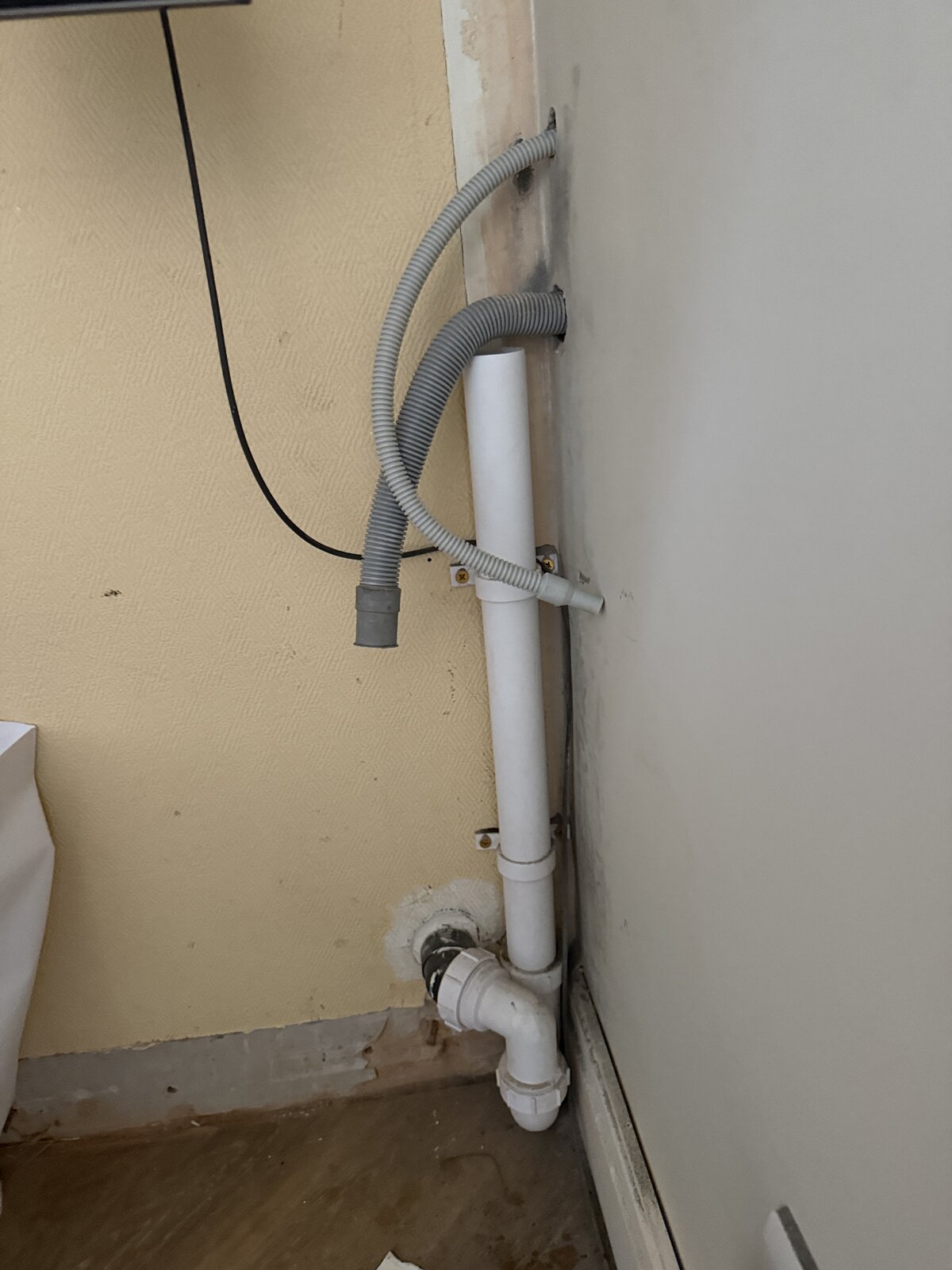

Will both pipes not just sit inside the top of the standpipe, like the pic with the WM hose? Clipped together with tie wraps?
Yep a 40mm waste is too tight. I could try swapping out for a 50mm waste then just shove both pipes in. Not sure if it might get overloaded if they both dump at the same time though?
Shouldn't do, as long as the waste run to the outflow is clean and clear and the fall is ok.

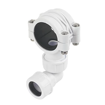

You could also use a condi clamp on it for the TD, WM still goes in the top and the clamp goes on the side
