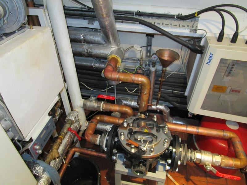

Hi,
I have an issue with a supplier and I try to put my mind at ease.
The situation is the following. PN16 flange - 4" to 4"-2" malleable reducing bush is leaking. I use Loctite 55 with a smear off La-CO Slictite to make the installation smooth. the number of threads of the Loctite 55 followed to the T.
Any how it was leaking at 1 bar pressure, so i dismantled the application and remade the joint (took 2 hours). and it leaked again. So I went down to supplier and picked up a new one. Assembled the same way as usual - no leak. So I took the one existing one back to them. I made a mistake of not disassembling the connection (flange and reducer together) and they were claiming that the thread is not run fully together. although it has not leaked ever on any of my connections before. now I am in doubt. the flange and the reducer has at least 10mm connected thread lenght. which means the 4" male thread of the bush is in half way to the pn16 flange female thread. I will also upload some pics.
Could anyone advise me on the minimum thread numbers for connecting 4" iron pipes for low pressure applications (3bar)?
