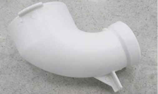

Hi
Has anyone had experience of a Porcelanosa Smartline cistern leaking where the down flush pipe attaches to the cistern outlet? It's a "push and twist" fit pipe that goes on a short pipe at the bottom of the cistern and sealed with two "O" rings. Picture of the pipe attached. The replacement pipe doesn't come with "O" rings and Porcelanosa say there isn't a separate part number for them. Any suggestions please (apart from don't buy Porcelanosa!)

Make a O ring
Cut and super glue. You can buy O ring cord off internet.. like......
Could use CT1 or stixall to seal as a plan B
