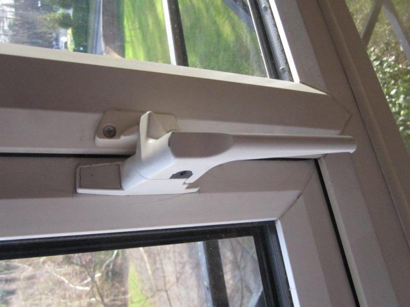

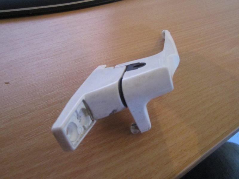

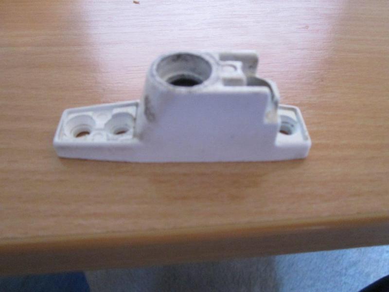

I need to replace some of the Window handles in my flat, but the type that are fitted on to the windows at the moment do not seem to be sold anymore and I have purchased a number of non-suitable replacements.
Anyone seen any place where these can be purchased from? I've looked through most of the online stores and none of them sell this hooking type of cockspur handle:
As you can see, the wedges are also non standard and sit on the frame at an angle to make the contact with the handle flat.
I'm going to need about 20 handles to replace all of them in the flat, most of the handles have snapped off which is a real pain if I want to close the windows!
Be very grateful of any suggestions.

There is no part number or markings whatsoever on the current handles.

The problem is the stack height actually, these are huge. I've ordered ones of every size and 21mm is still not high enough.
My old ones appear to have a stack height of 25/26mm and nowhere sells them.
It's difficult to see from the angle the first picture is taken from but it looks like although the spacers are fitted to the bevelled angle of the frame they still come to a flat face which sits "proud" of the frame because of the raised ledge section. Could you cut/buff some of the thickness away therefore reducing your offset to a distance suitable to a handle you can get? The spacers on mine are pushed into two holes in the frame and can be prised off, although I did see some glue residue under one. You might be able to remove them and cut them neatly on a bench.
