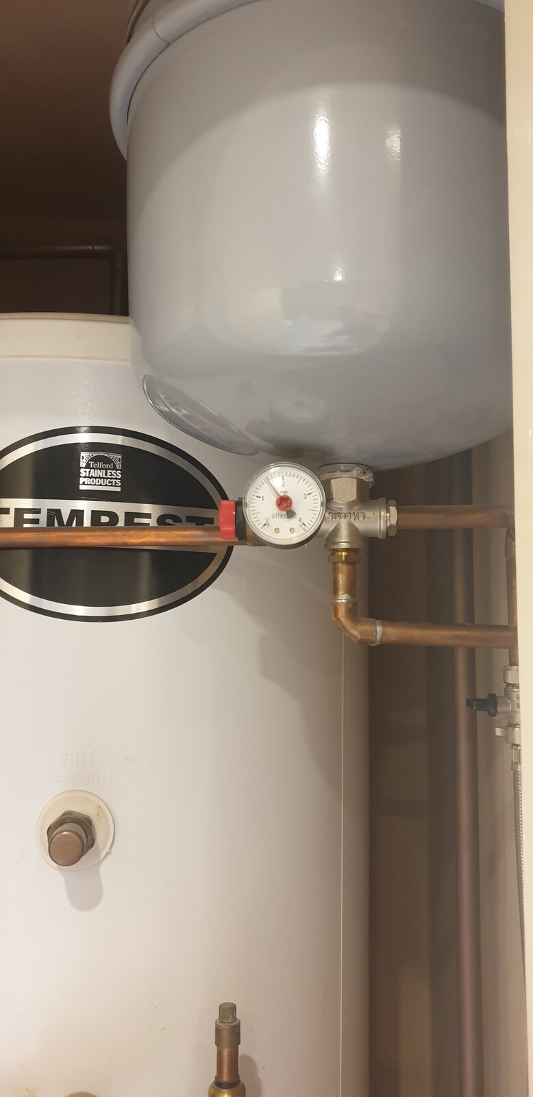

Take some pics to show us of around the hot water cylinder , looking for any thing that looks like a box fitted on pipework,with electric cable coming out of it.
Here's the tank

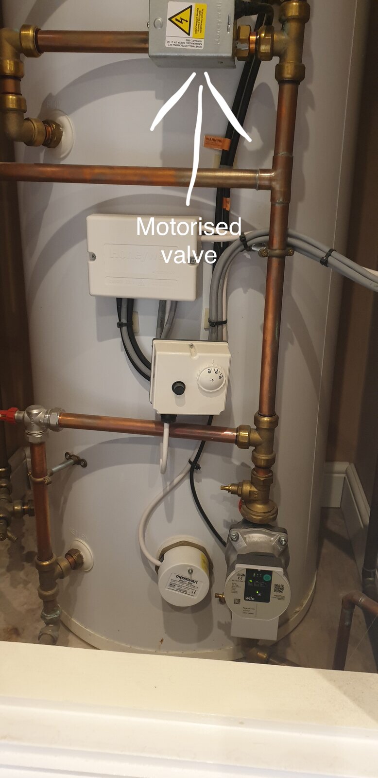

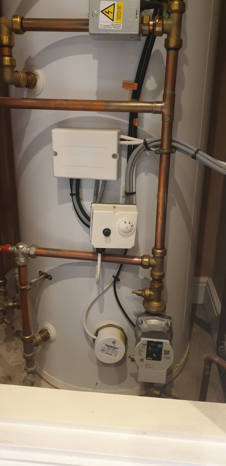

Looking at your wiring, there’s at least 2 of these, and these are motorised valves. They tend to have a microswitch stick which continually calls for a demand even though there isn’t one.
