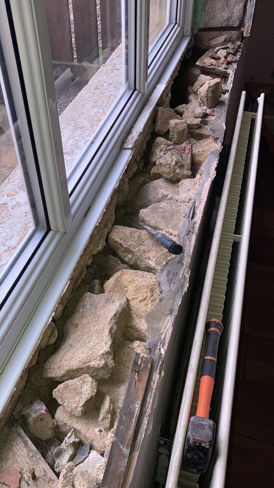

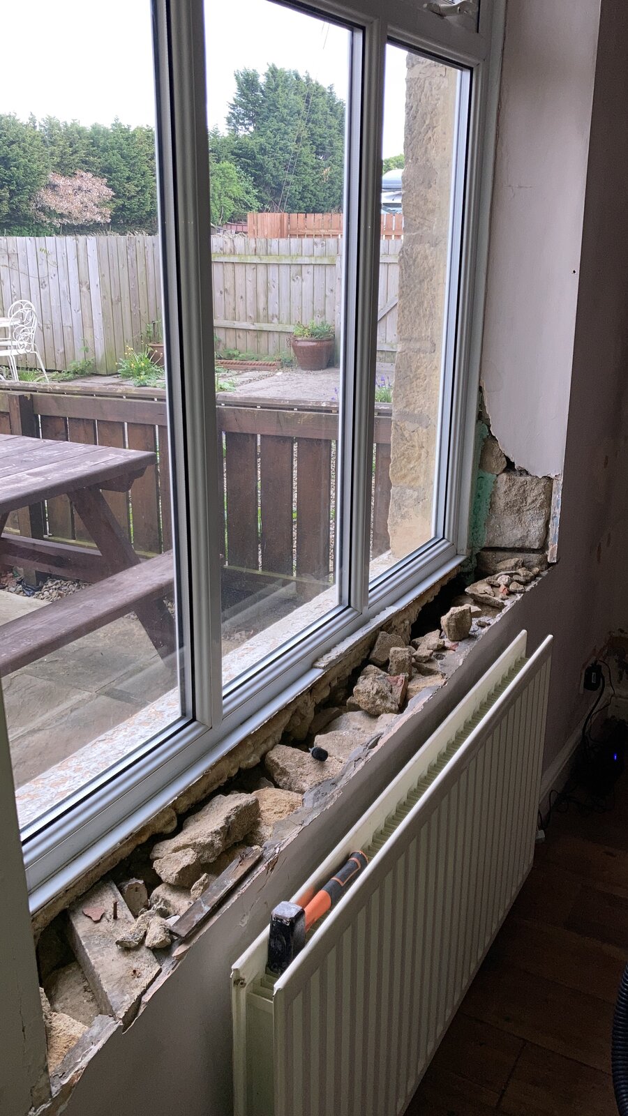

Hi all,
After some advice please.
Slowly doing up a stone terraced cottage and I’ve pulled out a window sill as of a noticeable draught from where it meets the wall.
This has revealed all inside to be loose where the old mortar has gone to dust.
I’ve removed all loose with a vacuum and want to fill it with some kind of a pour in solution.
Does anyone have any experience of this or can recommend a product.
I don’t want to be removing all loose and bit by bit brick laying in the void. Cheers

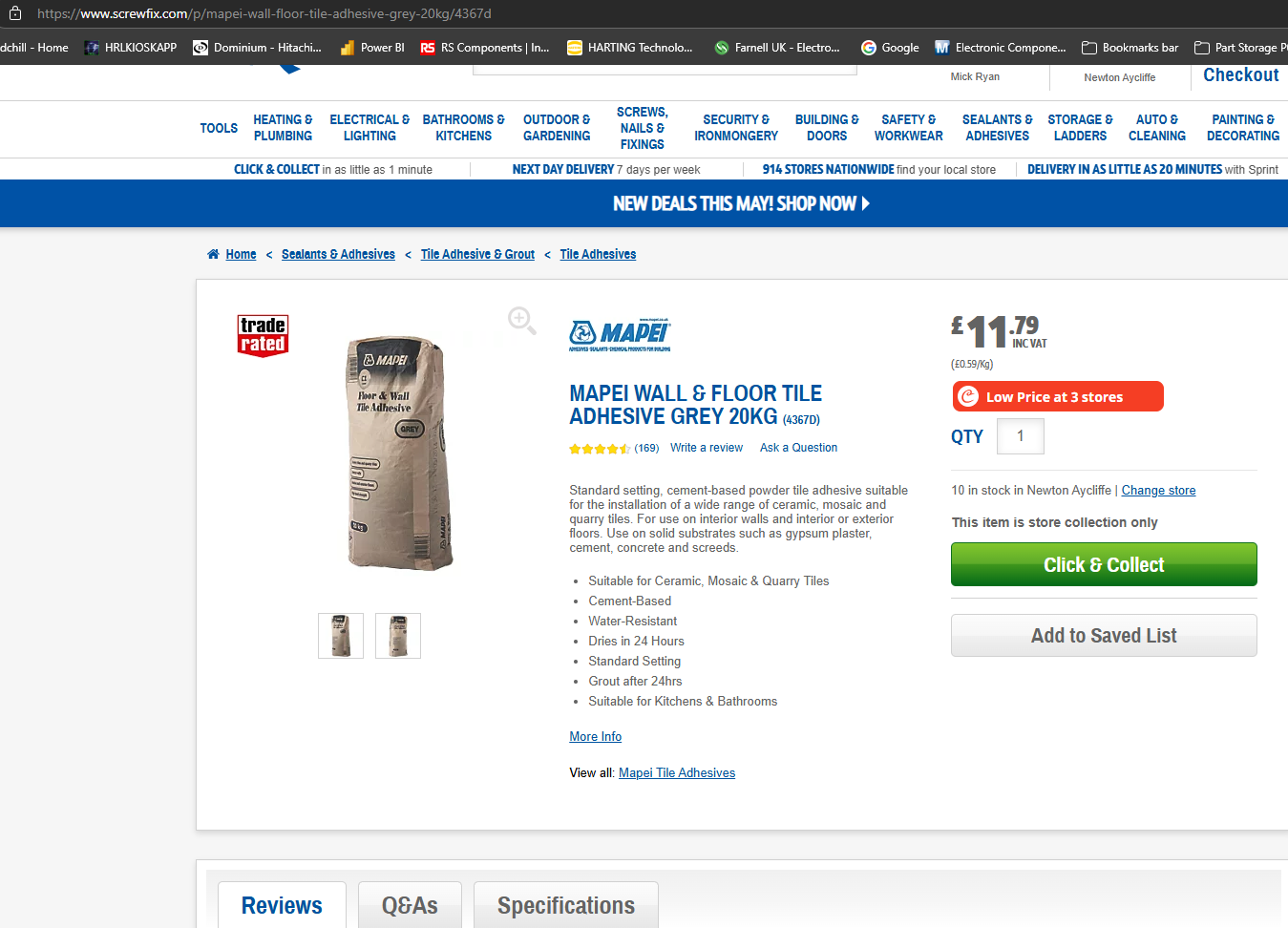

Hi Tom, Thanks for your reply. A Grout you say? I would never have thought to even google for a grout solution.
In my old mind thats just for tiling lol

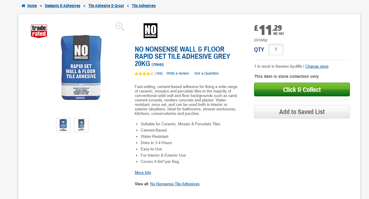

Is it like the below tile adhesives? thanks
It's not an adhesive that you want, it's a grout, as in the link I provided in the first post.

That'll work.
If you're doing several bags, start with a thicker mix so that the grout doesn't completely get lost to the bottom. And subsequently use a thinner mix as the voids fill up.
You will be surprised how it finds its way through any gaps. And you arrive at a level finish at the top.
Edit: I notice in your first post, you talked of a draught. The hole or crack or whatever that is allowing the draught to enter the wall might allow the grout to escape.
If you can find it, plug it. Otherwise your grout might end up on the floor.

Its going to be difficult to apply a sealer to all the sandstone bits though before I start the grout pour. Actually thinking about just pouring it in whilst moving along the area with the bucket. Not sure how else to remove any absorbant areas bar pulling out every stone piece from the void.
You don’t necessarily want to fill all the voids with something solid; in a stone wall, voids improve the thermal efficiency. Of course the stones need to be secure enough for the wall to not fall down. But you do want to stop draughts. I’d be tempted to mortar together the top layer of stones and not fill below there.
