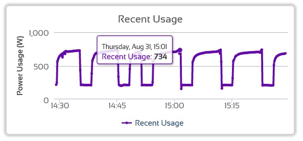

But drying time was much longer, half the power used 600 watt v 1000 watt, but also double time 3 hours v 90 minutes. So seems no saving, but to be fair we did often have to switch the vented on a second time, and the heat pump one does take more clothes so not really a direct comparison.
When we bought the old vented there were versions designed to run over night with a 500 watt heater, so no real change, low wattage tumble driers have always been around.

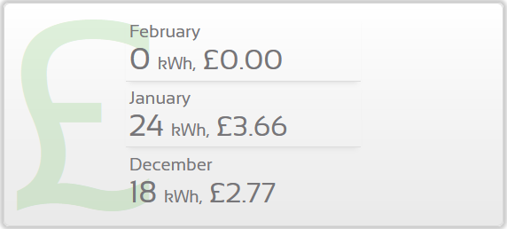

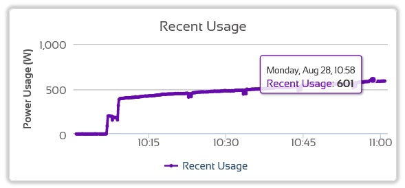

But I have never owned a air cooled condenser drier. So out of interest how do they compare? Can you set them for a low power long drying cycle? And do they really heat up the room they are in? I set mine for a delayed start to con inside when likely to get more solar power, can the air cooled do the same, and if set to 600 watt how long would the air cooler type take? And is the heater on all the time, or does it cycle off/on like the heat pump type? Showing energy meter results Thursday 31 Aug big load Mixed 3.jpgdue to the heat pump turning on/off it is hard to say how much energy is used, from the start Monday Aug 28 2.jpg one sees the power use slowly rise, the meter does show average today, but wife taken over laundry so no idea if large or small load, it shows monthly totals 1706973600895.png but since I don't know how many loads, not a clue as to cost per load, but at £3.66 hardly going to break the bank, so main point is it takes so long hard to dry two loads in daylight when the solar panels are producing.
