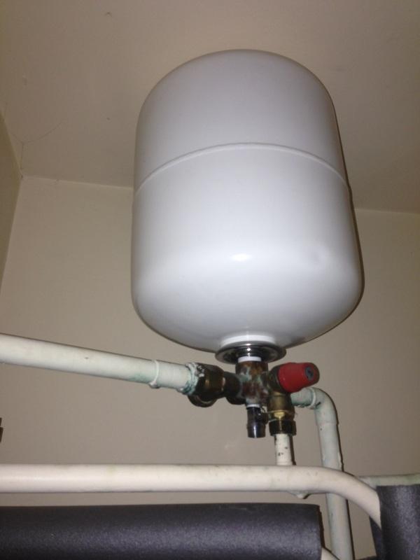

I've just had a look to see if I can press the value on the vessel but I have a problem ... the top of the tank (there is a black twist cap) is actually touching the ceiling and I'm assumming thats what I need to get to ...

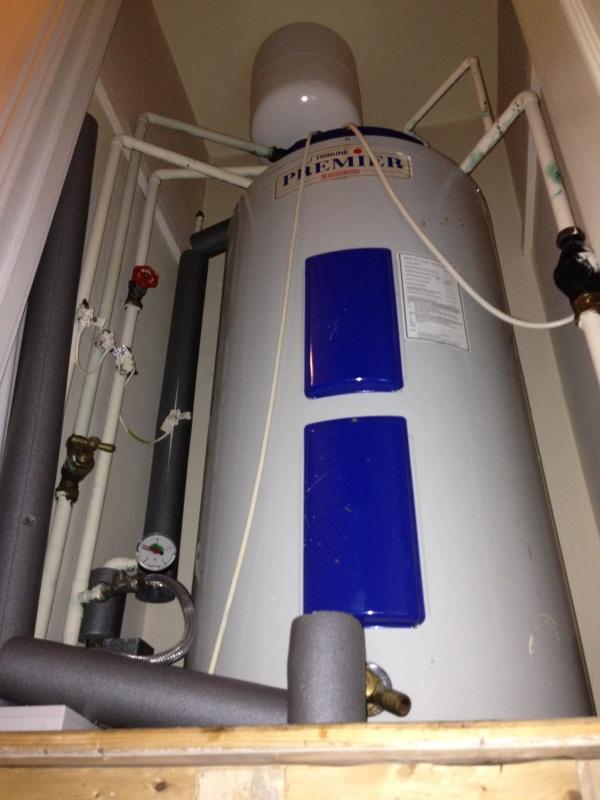

White are normally for domestic hot water cylinders, do you have mains pressure hot water?
Red ones are for central heating, or it could be in your boiler, what's your boiler model?

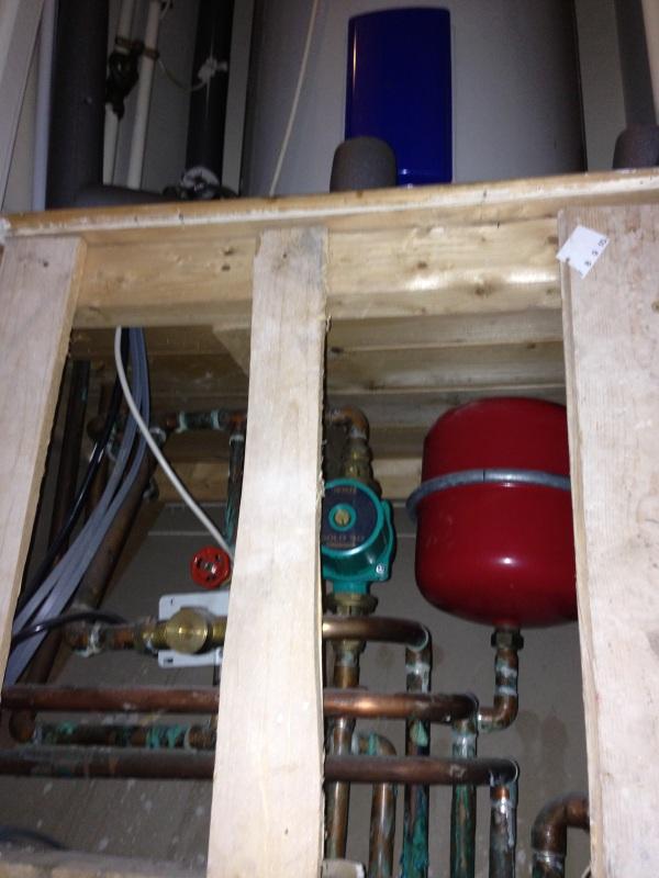

Thanks Paul, boiler is a Baxi Solo 2 40 PF ... managed to get the bottom panel removed from underneath the cylinder which reveals this ...
cylinder and cylinder vessel above ...
I can get my hand in the top of the red one but still really tight.
