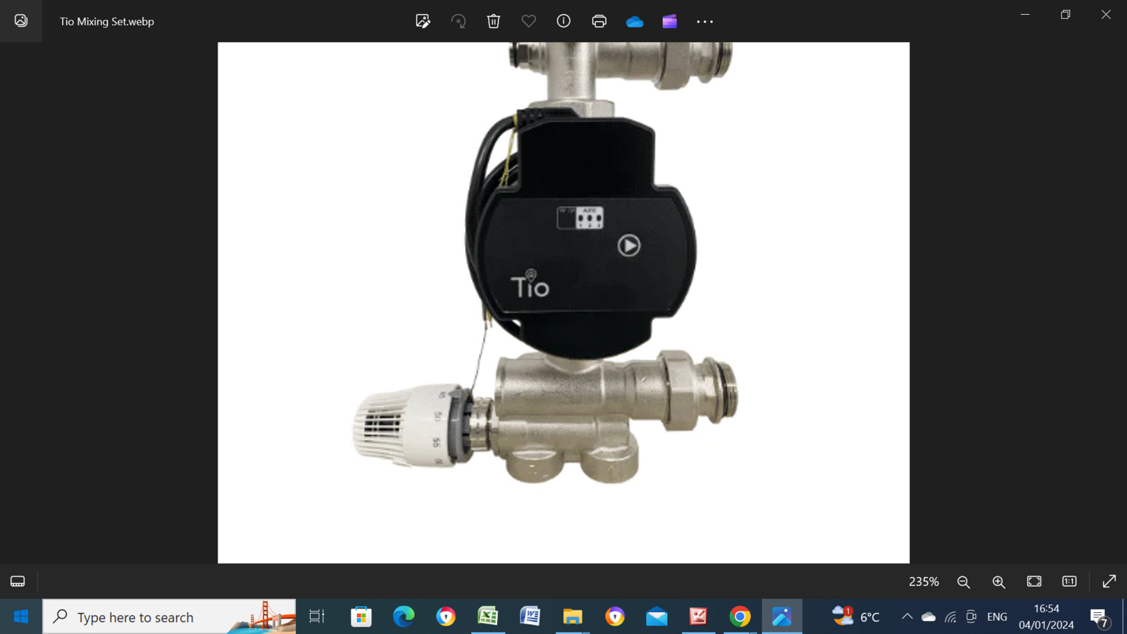

Its strange but the Tio mixer below shows the flow and return reversed??.

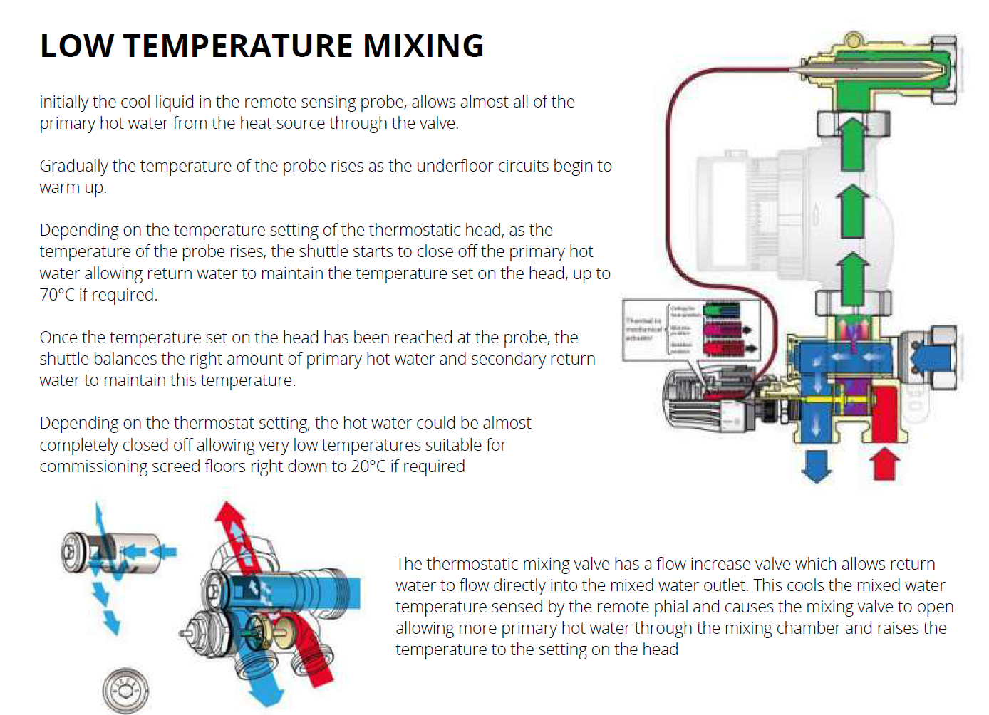

Here is, IMO, a proper type (TIO) mixing valve that uses external mixed flow temperature (manifold flow temperatue) measurement using a capillary sensor.
Apart from the external sensing, it works almost exactly the same as any TMV, it has a shuttle valve that controls the mixing by changing the hot/cold flow rates, additionally, it also has a loading valve designed to maintain the required mixed temperature between low and high UFH demands.
