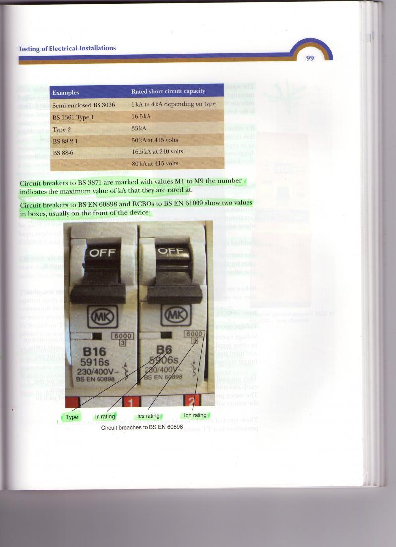

I don't think they print the servicable fault current on the MCB, the one in the box is just the maximum.
It is plausable to fit a board with a lower max fault current providing that backup protection is provided.
The full figure e.g. 6000 is in Amps and is the maximum.
The single figure - normally directly below e.g. 3 is in KA and is the serviceable figure.
The single figure in the square window - whoops - I mean box :D is the energy limiting class as given in Annex ZA, Tables ZA 1 & 2 of
BS EN 60898-1 2003 + A1 2004.
The figure could be a 1, 2 or 3 - indicating the energy limiting class.
Table ZA1 deals with mcbs up to 16A and table ZA 2 from 16A to 32A. MCBs above this are not included in this classification.

We were informed, (wrongly, it seems), that this was the serviceable breaking capacity figure - and this from a NICEIC assessor. :)
The mcb is marked with its Icn rating - that is its Rated Short Circuit Capacity.
The Ics value does not have to be on the mcb - this is its Service Short Circuit Capacity.
For BS EN 60898 MCBs: Ics = Icn * (factor k) Where k is just a number given in this table.

You need to give Christopher Kitcher a ring, though, coz in his book - 'A Practical Guide to Inspection, Testing and Certification of Electrical Installations' - he seems to disagree with you.
The photo below is scanned from page 99 :confused:

I can't make out what he has written, but tell him to read page 135 of BS EN 60898-1 2003 + A1 2004 :D.
Annex ZA is Normative meaning that it is part of the standard. Further information is available in the related standard BS EN 60947-1, and from the eiema web site.
Download their circuit breaker guide here: http://beama.org.uk/en/publications/guidance-leaflets.cfm/circuit-breaker-standards
Look on page 7 for the table (note that the formula has a typo, it should be multiply not subtract).
I am afraid this guide does not deal with energy limiting classes - you need the standard for that.
Then throw your book in the bin :D:D.
