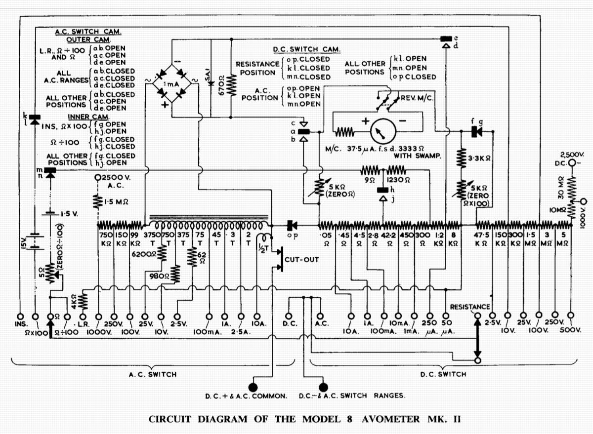

You might want to look at following for ammeter design for DC current measurement
http://www.allaboutcircuits.com/worksheets/meters2.html
Or
http://www.richardsradios.co.uk/Images/mk2diagram.jpg
which is AVO 8 showing both DC and AC current measurement.
