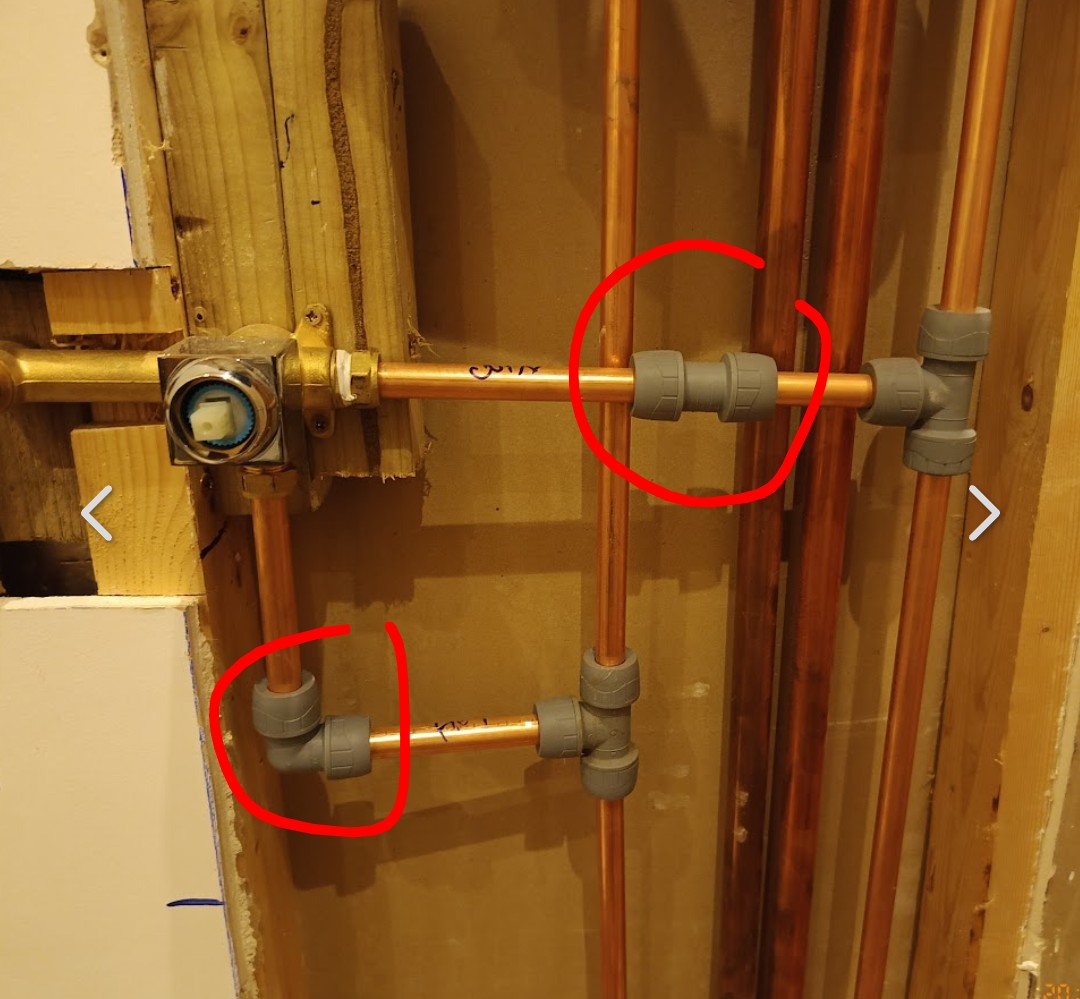

Also while you have the chance, reconsider the plasterboard around the shower area. Plasterboard and wet zones dont mix well
Perhaps the multi-trade bathroom installer doesn't have hot work insurance? It's perhaps not a case of "can't do", but "won't do" in that situation.
Only a 1/7th of the payment. I have a payment plan at each stageHave you paid them yet?
This is an existing wall, what would you recommend instead of plasterboard?Also while you have the chance, reconsider the plasterboard around the shower area. Plasterboard and wet zones dont mix well
Thanks.Will final finish be tiles or shower panels? With either I'd recommend a backer board system, waterproof & inert, with joints taped and tanking applied. Plasterboard will cause issues down the line.
Yeah, that's what I'm thinking. Too be honest, once this major work is done. The rest is on top so I'm hoping that would be easier to complete and not so many issues and need the bathroom back in service.If he can lie to your face, what else is he capable of???
I would kick him out.
Plasterboard with bonding on will not support the weight of the tiles, let alone the risk of water leaks. I feel for you. You came here looking for advice, I think our advice is looking like sacking your 'contractor' and getting someone to redo the work, with correct materials and methods. It will cost you a lot less in the long termThe tiles are quite large 1200mm x 600mm.
Is it this type of backer board on the walls?Will final finish be tiles or shower panels? With either I'd recommend a backer board system, waterproof & inert, with joints taped and tanking applied. Plasterboard will cause issues down the line.
