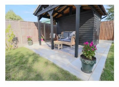

Yep, that'll do! I built this one from scratch a few years back. The main posts were coated with blackjack before being set in concrete. I used C24 timbers and concrete tiles for the roof. We call it the 'shedzebo'. It's basically the lovechild of a shed and a gazebo. Hmm... anyway. Good luck!
