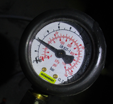

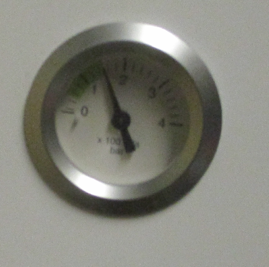

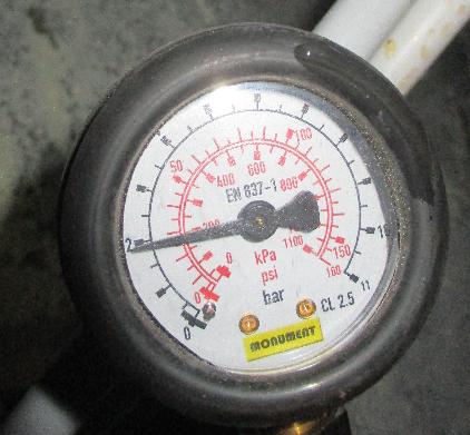

Here is an example. Rads on lower floor not working, all other floors (4 above) all working fine.
Expectation is that pressure at the end of the line (22mm main) is insufficient to provide pressure suggesting the need for an additional pump.
I created a connection point at the end of the flow/return main and connected a simple pressure gauge. What I found was the opposite of what I was expecting.
The pressure was actually greater at the very end of the circuit than it was at the beginning. I also discovered that both the flow/return had the same pressure meaning that no flow could occur.
In this scenario, there could be no flow due to higher pressure and no differential.
Now this balance will be back in equilibrium once the air is expelled but I'm now adding air purge traps to the end of each circuit to ensure a speedy purge.

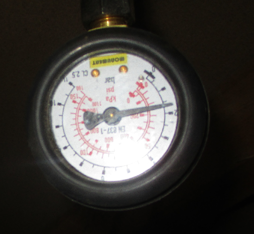

Todays reading....air being vented...pressure dropping on circuit
