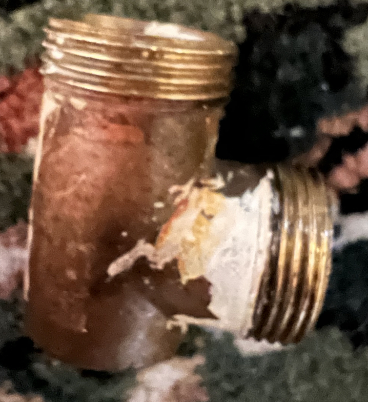

Friend has a leaking radiator valve, the radiators and valves are ancient.
Couldn’t find a drain, so had to manually drain from this valve. Took it off, went and got a new radiator valve, but couldn’t screw it on.
It looks like the threads are different, is this so with a, what looks like, is a Mistral valve which is written on the adjuster?
I put it back on but still leaking. I’ve went on toolstation and found they have “Pegler Mistral 2” is this the same type? Are the threads different from standard rad valves today, as the one I originally got looks thicker threads compared to the one removed?
The connection into the actual radiator is caked and I don’t want to risk trying to remove that, they would have to pay a plumber to do that, and/or replace the whole radiator.

Old 1/2" valve nuts will have different threads from the newer 15mm nuts for sure. The nut and olive would need to be removed (pulled or cut) and the rad tail possibly changed too, depending on whether the new valve uses a 15mm compression tail or a 3/4" union.

1. The part that screws into the radiator is called a tail.
2. There are two (main) types of tail:
2a. Compression tails. The threaded part screws into the radiator sealed with PTFE tape or similar. The other end is a plain tube, usually chromed brass, 15 mm in diameter. The valve connecting nut is slid onto the tube, then an olive, then the nut is tightened onto the valve, compressing the olive and making a seal. The thread on the valve is usually a male 1/2" BSP thread, which has an outside diameter of a fraction under 20 mm.
2b. Union tails. The smaller threaded end screws into the radiator, as a compression tail. The other (valve) end is a convex conical fitting and between the two is a captive nut with its non-threaded end facing the radiator. The valve has an equivalent concave conical surface, and behind that is threaded 3/4 BSP. The captive nut on the tail fits the thread on the valve and pulls the two parts together. The seal is made by the metal to metal contact of the curved cones, although a little sealant is often used. The outside diameter of a 3/4" BSP thread is a fraction under 26.5 mm.
3. Sounds as if your old valve was a union fitting but the new one you got is a compression fitting. You have two choices:
3a. Remove the existing tail and fit the new valve with its new tail.
3b. Return the new valve and get a replacement with a union fitting.
4. The Pegler valve you referred to is a compression fitting valve. You can get TRVs with union fittings, but they are rare, and quite expensive.

Thanks for explanation. As I say I’m not a plumber but happy to help people where I can.
I understand what you are saying, if replacing the rad valve fixes it, I’d be happy, this is what I’ve looked at…
https://www.toolstation.com/pegler-mistral-2-trv/p33889
So there is no way the existing nut on the rad tail will fit the above?
The “normal” one I got today wouldn’t screw in as the thread must be different so obviously didn’t force it.
I’m not going to chance removing the rad tail as it’s old and looks caked in, so I’d be worse off, they’d have to get a plumber to do this.
Maybe I could remove the old nut and olive off the rad tail and use a standard rad valve fitting though?

Here’s a pic of when the old rad valve was removed, with the top bit (where it’s actually leaking from, the screw in bit), with the threads on that don’t seem to fit the standard rad valve I got today.

I think some of the Mistral valves are 15mm, so unsure why you can’t get it to fit, so perhaps it is 1/2”? Maybe just remove the nuts and olives and fit new altogether?
Just remove the nuts and olives and fit new valves.

You can carefully cut the olive using a junior hacksaw, usually diagonally and split further using a thin flat bladed screwdriver.
