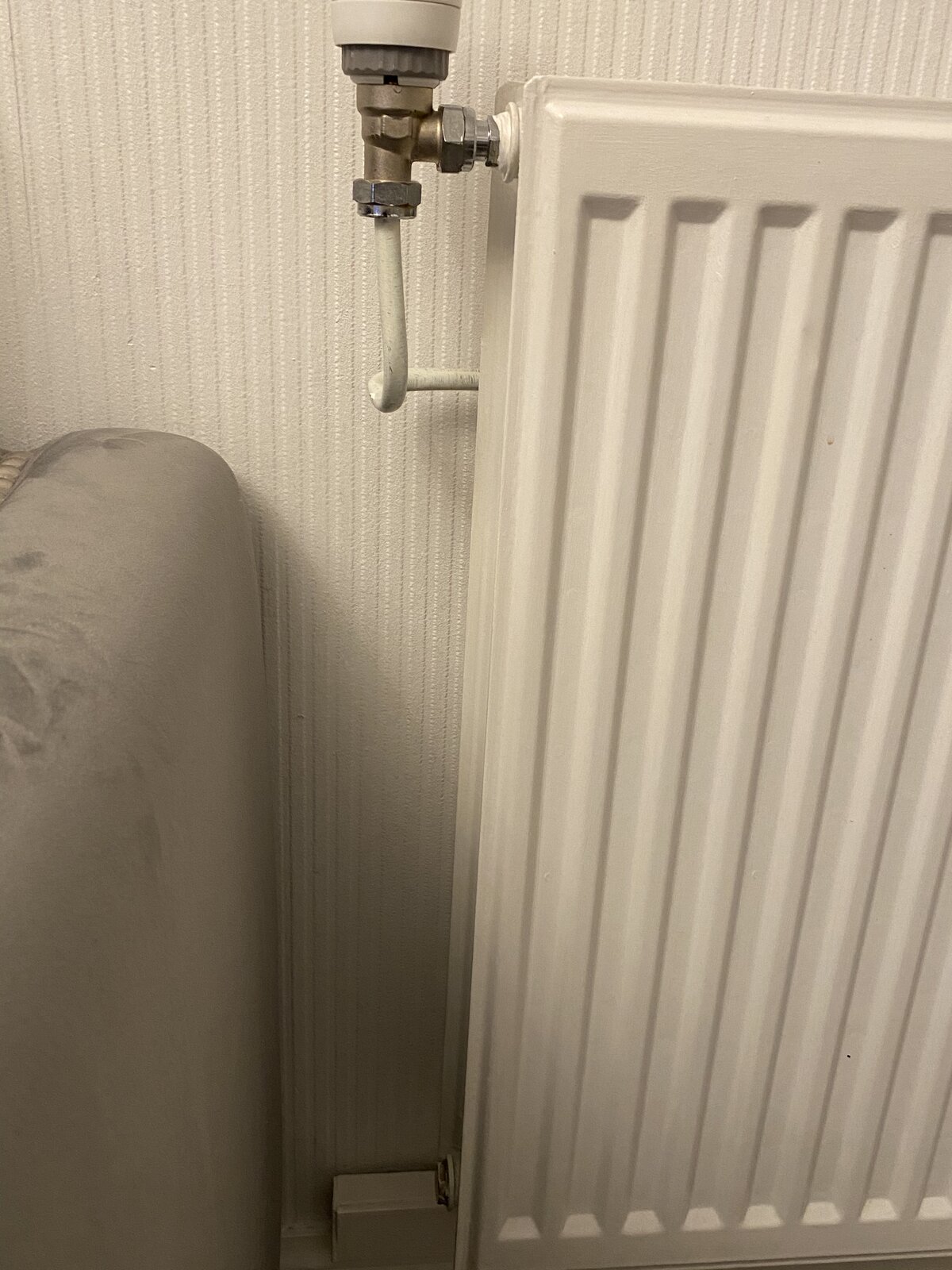

Hi guys my Mrs has decided to buy new radiator covers it says in description to fit all standard size I’ve obvs not got standard size so I am going to have to lower them but the thing that’s got me stumped is the tvr in the radiator as it sticks out the top I would need it to be at the bottom off the radiator is this possible to do many thanks in advance

The TRV would be sensing a higher temperature, not really relevant to the room temperature, because it would be in an enclosed space with the radiator. It might work, if the cover only covered the radiator, cut so as to leave the TRV outside the cover.
Thanks for your responses the covers have got plenty of slats on them. If I was to move the tvr to bottom of radiator would that not work better as it’s at a side where I could leave it outside thanks again for responding
Rad covers look nice but they substantially reduce the heat output of the rad, from experience.
To fit one you need to move the trv to the bottom of the rad, as others have said really the trv needs to be outside the rad cover
Radiator covers increase your gas usage by about 10% as you have to increase the temperature to compensate for them blocking the heat output. Radiators don't actually radiate, they convect - cooler air enters the bottom and flows vertically out of the top as warmed air. Anything inhibiting this airflow reduces efficiency.
You can fit remote sensing TRVs to ensure the TRV at least gets an accurate room temp reading. Not cheap though... https://www.directheatingsupplies.c...tic-radiator-valve-2m-remote-sensor-07-05-158
