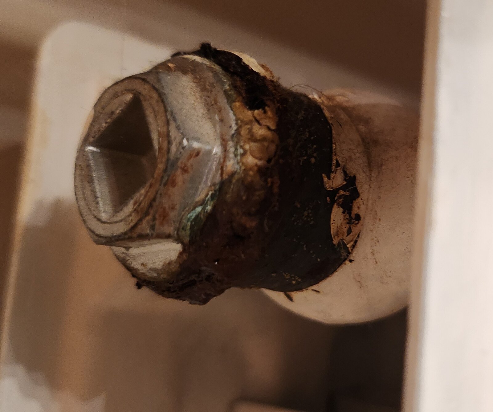

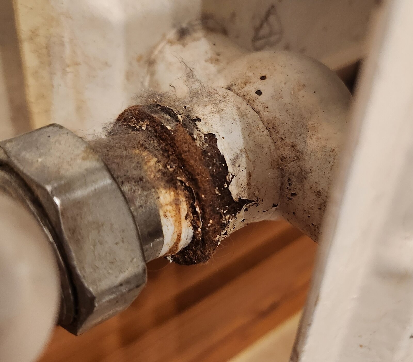

Hi all,
Having some work done soon to install a couple of new radiators and it got me wondering if it's worth replacing some others at the same time - we have a few with severe rust around where the valves enter the radiators for example.
I think the radiators in question have been in place for thirty years. Would they be worth changing?

Depends on how bad the rust is, valves must have been leaking slightly ever since tails were fitted. Do the rads warm up well overall and is it just around the rad tail tappings where they're bad? Is the system water clean? Do the rads heat the space efficiently? Are they convecting rads?
If so then drain rad, remove tails, use a small circular wire brush on a drill and clean and check the tappings in and out, if they clean up ok without losing any material then no need to replace, done it many times when changing to new valves. Use a little rust treatment and then refit tails, then a little white paint to seal up rusted areas. As long as everything is sealed back up properly then there shouldn't be an issue.

These are probably the worst offenders.
I'd always have a go and see if they would clean up. If they are badly pitted, rusted through then may be time to replace but they can clean up surprisingly well. The tappings tend to be made of nice thick material, especially on older rads.
Those rads look like early stelrad accords so totally steel rad .
One of first rads to be totally automatic welded.
Originally the plugs used fiber washers often leaked as you can see!

Rust is normally surface and will clean up without issue.
Deep corrosion is another matter
