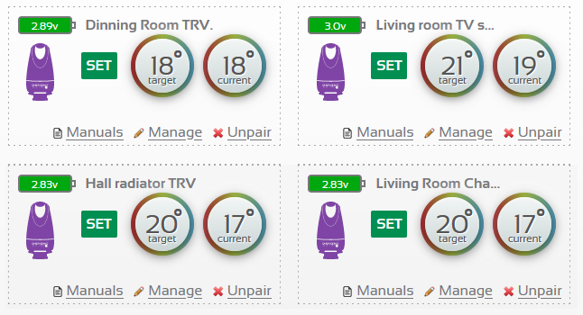

So main control is with the TRV's, and the four electronic TRV's I fitted to mothers house gave me both target and current temperature. 4 TRVs-1.jpg as a result setting the lock shield was made easier, if after heating had been running for some time target under current open the lock shield a little, and if over close it a little, and once set all rooms on a dull day worked A1, the bay windows still caused a problem when sun came out, but that was reduced from 32°C to 24°C when set at 20°C. The reason was two fold, the TRV worked faster, and the water was cooler to start with so radiator cooled faster. On leaving the house after mother death, we replaced the electronic with the old manual, and found not lock shield set, these worked nearly as well.
But setting the lock shield not easy, my first attempt starting closest to boiler, was close each lock shield and allow radiator to cool, well at least pipes, then open ¼ turn at a time, until pipe got warm, then move to next radiator, this did mean all radiators worked, no one radiator was starving the others. However the hall radiator where the wall thermostat was, proved a problem.
When front door opened hall went cold, as expected, and to set the lock shield to get radiator hot enough to reheat hall, resulted in once reheated it turned off the boiler so rest of house cool, closing the lock shield in the hall rest of house warm, but hall never heated up. I was told not to fit a TRV to hall radiator, but I did, and that transformed the heating, now when door opened hall cooled and TRV turned on, so reheated hall fast, but before it reached the 19°C set on the wall thermostat the TRV had started to close, set at 17.5°C it would in fullness of time switch off the wall thermostat but only on warm days, or when a scheduled change was programmed, i.e. over night, however to have a programmable wall thermostat you also need a programmable TRV so they match each other.

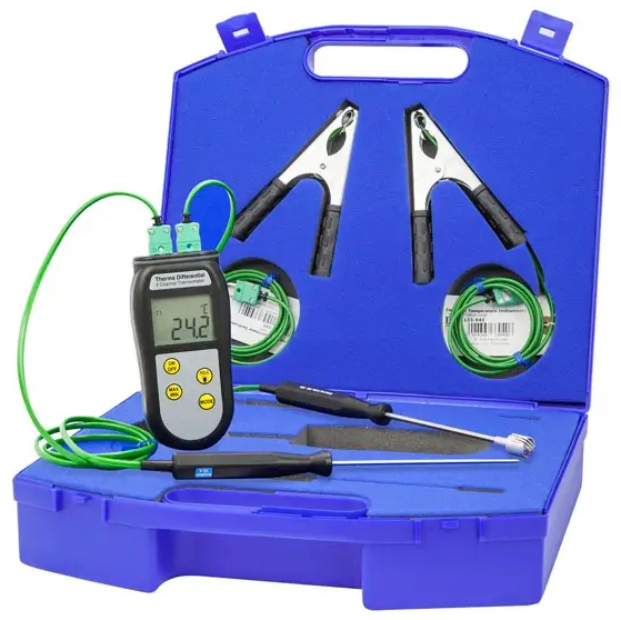

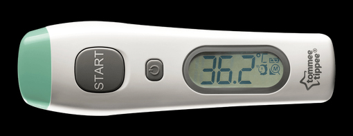

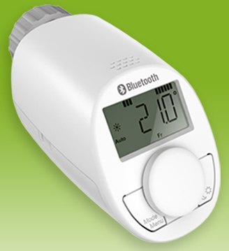

This cheap TRV 61dmtMm13BL.jpg only shows target, so harder to set lock shield valve, I tried setting them with this thermometer.jpg thermometer, it did have a setting for babies bottles etc, so theory should have worked, but in practice I could not get a steady reading, the plumbers use some thing like this upload_2021-7-1_2-12-2.png which I assume does work, and it should have been set up for you. However to date I have not seen any plumber/heating guy use one, maybe they did and I missed it, but my parents house every lock shield valve was wide open, central heating part paid for with government grant, but the installer actually failed to change the power shower which was illegal to use once the cold and hot water was direct from main with no header tank, so clearly a cowboy firm.
Certainly sounds like the system needs balanced, basically your rads are getting rid of the heat entering the rad before enough hot water can circulate properly to heat the whole radiator therefore the radiators aren't working at proper efficiency. The delta T - the temperature difference between the water in to the water out - should have been set when the system was installed and comissioned.
