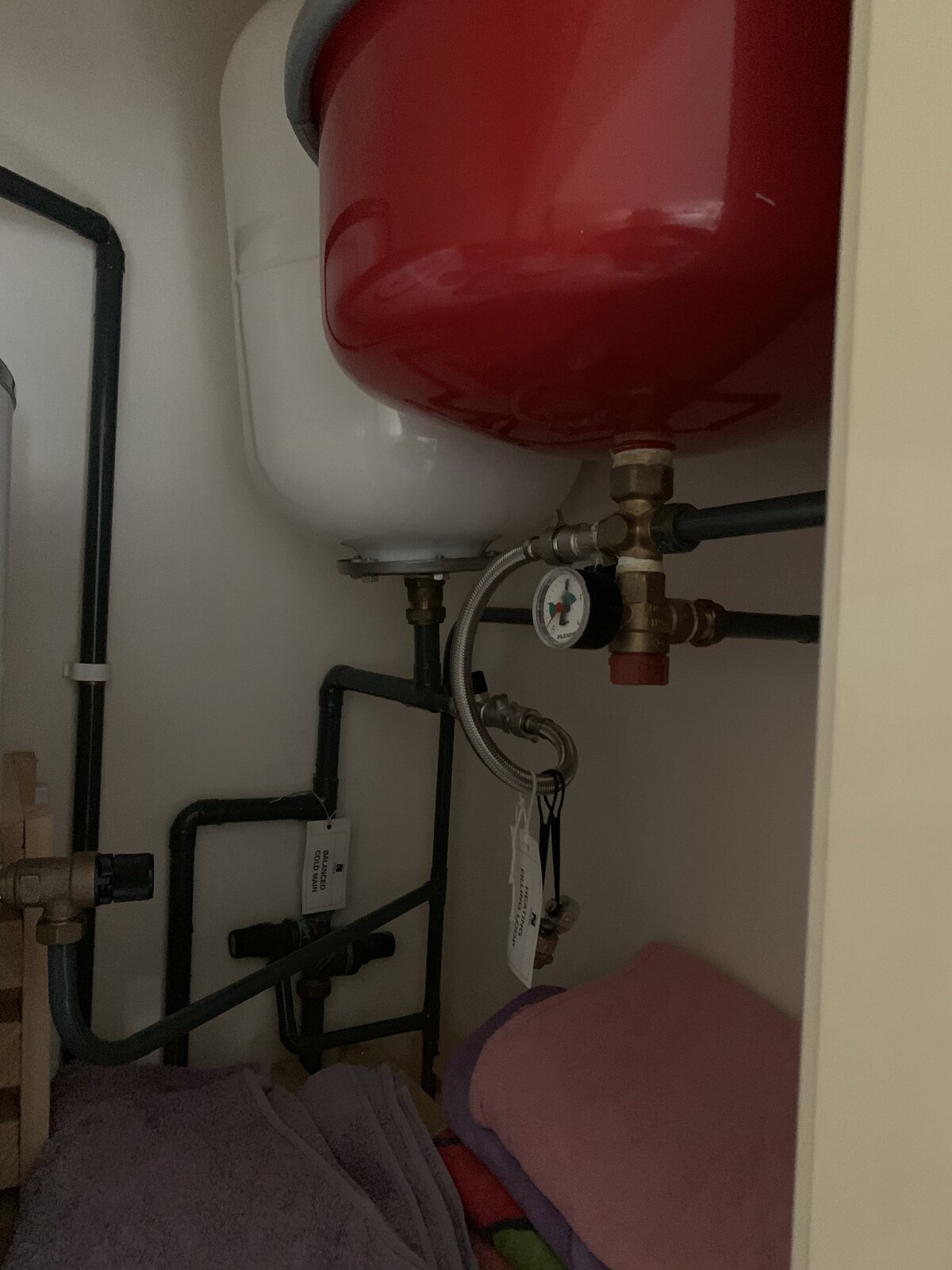

Any help / guidance welcome - radiators upstairs (middle and top floor of house) cold but warm downstairs. Have recharged the system as pressure was zero. Also bled radiators upstairs - initially no water or air coming out of top floor ones but now water comes out but no heat. System has red expansion tank with pressure gauge connected to outlet from main cylinder. Also what appears to be a white expansion tank connected to balanced cold mains. Both expansion tanks connected via heating filling loop (which I opened to recharge the red tank). 2 wall thermostats (bottom and top floors of house). Have had heating on for half a day with both thermostats at max, pressure is maintained, but still no heat in upstairs rads.
Red tank appears to have water in it when I tap it - white one sounds empty. Red tank shraeder valve let’s air out, nothing coming out of white shraeder valve. Pump plate checked and seems ok and can hear it running. Both the main cylinder and the cold water combination valve have separate valves that when I turn them allow water to flow. Main cylinder one pipework runs to base of red expansion tank and pressure gauge, and cold water combination valve one pipework runs to base of both expansion tanks.
Anyone got any ideas for getting heat back upstairs?? Thanks, Rich.

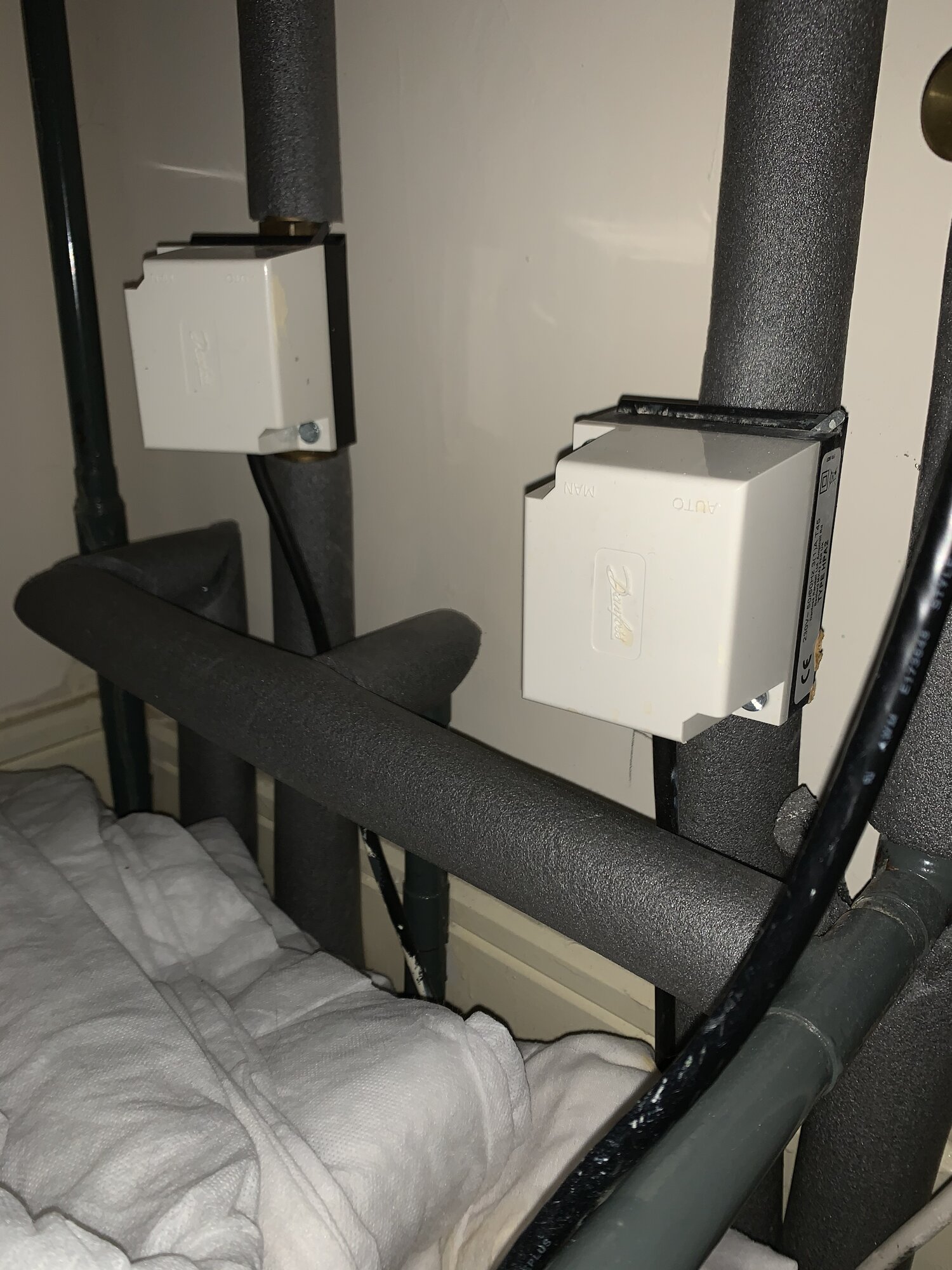

Hi transam. The upstairs wall thermostat clicks as it passes 19degrees. There are 2 white components in the airing cupboard pipework - they have a manual and auto setting via a lever on the top - are they zone valves? Thanks.
776C5839-C9FB-4DD7-9C8F-F45813EE3EE0.jpeg Here’s a photo of the system.

Yes they are zone valves

danfoss make by the looks of it
2 screws will undo and the heads or motors which can be removed / detached from the body no need to drain system
my guess is either the motor / actuater is not working or the valve body is stuck and seized and the motor cannot turn it / open it
Thanks. I’ve moved the levers from auto to manual. I can feel resistance and hear the motor running on only one of them. I guess that’s the issue? thanks transam. I’ll disconnect the faulty one and have a closer look. Thanks again

Had another play around - it appears it’s the valve that I can hear and feel resistance on when I move from auto to manual that is at fault. When it’s in auto there no heat upstairs, flip it to manual and I get heat! I guess that means the boiler could be on permanently if not in auto mode?
The other valve lever just flops from manual to auto but in auto position it seems to work.
In most cases when a motorised valve is energised the lever will be floppy
The manual lever is generally to allow the valve to be opened for draining down / maintenance ect
Providing u create a demand via the other 2 valves and keep the duff valve open or remove the head from its body and leave valve open heating will work up stairs
Replacement heads are generally readily available from various merchants
