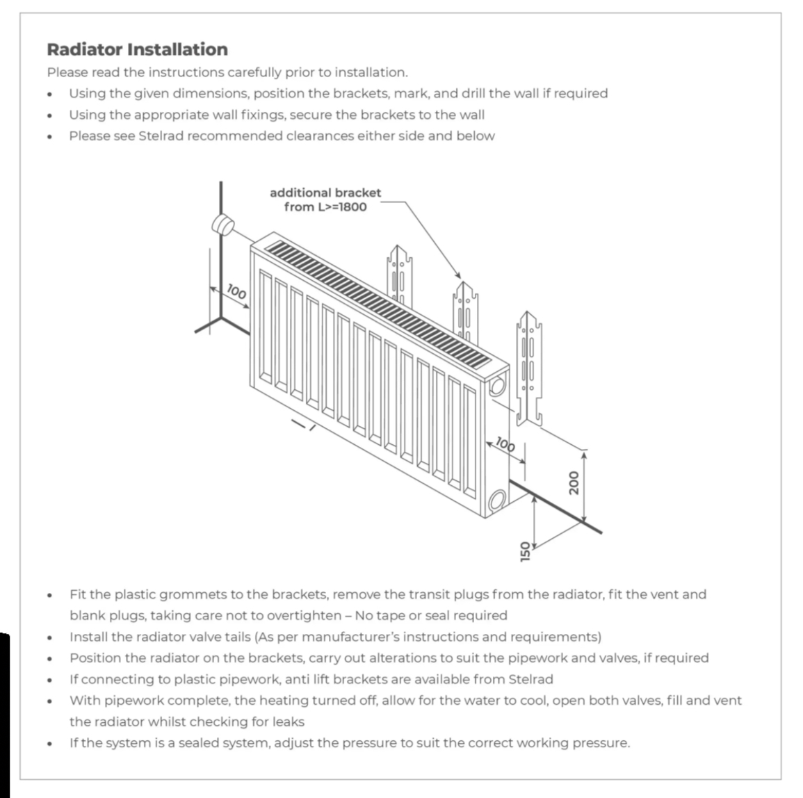

The radiator manufacturers often specify a minimum distance from the floor; for example, this Stelrad diagram shows 150mm:
Presumably the issue is that without enough space below there is reduced incoming airflow for the convection to work, so you don’t get the expected output.
If e.g. the window cill height makes this difficult, it has never been clear to me whether it would be better to use a smaller radiator with the required gap, or a larger radiator without the required gap. Thoughts anyone?
@endecotp - yes.
By coincidence, I’m looking at STELRAD too.
So that diagram very useful - thanks.
450+150=600 cill height, so I’m on limit.
I might have to put wooden batten spacers behind brackets as the cill might make access to hang on bracket tricky (as I won’t have a gap).
D
