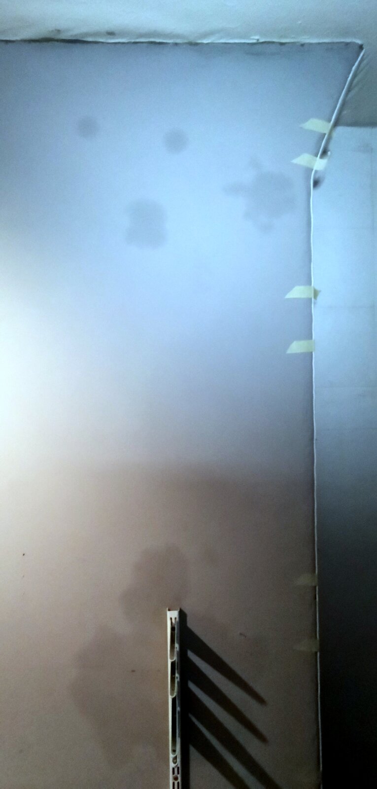

Random damp patches on wall
6 Sep 2016
451
5
I have a spare room with a cold outside wall that has always had condensation hence drips of water. I have hung insulation lining paper with Warlock thermal paste to the left side of the chimney breast. The wall is much warmer. So far so good. I am about to hang it on this side of the chimney breast but there are random damp patches I can't fathom as it isn't condensation (no water run marks). Even stranger are the damp patches on the chimney breast itself which has a gap between it and the outside wall. In fact, the downstairs fire is being used so there is warm air between. The chimney itself was pointed 2 years ago, as well as a new roof. No leaks at all there. and I have storm dried about halfway up the outside of that wall (I need to get higher with some scaffolding to finish) I have also invested in a dehumidifier. I can open the window as much as I can but not in cold weather as I* will lose heat.
So apart from not knowing what is causing these patches, I am hoping that covering the wall with the insulation paper will stop it. I shall try and get higher up (perhaps extended paint roller up a ladder) to finish the storm dry as soon as we get a couple of rain free days as I suspect the odd spayed bricks may be the culprit. The house was built in 1883.

Damp on and around chimney breast is usually down to unventilated and or uncapped chimney pots .
The fireplace would normally keep the area dry as it heats and causes very high levels of ventilation .
Remove the heat source without capping the chimney to reduce rain ingress and adding ventilation result in damp.
It might be hygroscopic salts in the chimney breast itself. They absorb moisture in the warm months and when it becomes cold and damp, they dump them through the neighbouring brick work.
Take a photo from further away (showing the chimney breast as well).

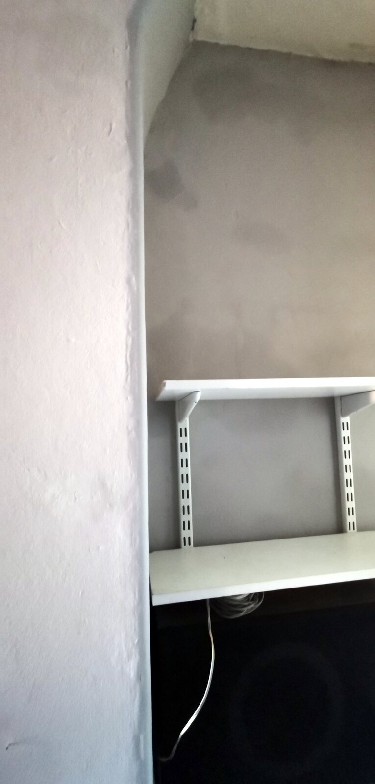

I have covered the recessed walls with the lini8ng paper and it has made a huge difference. The walls and room are no longer cold. Just can't fathom why the chimney breast which has a cavity behind it has damp. I was going to leave the chimney breast and paper with normal lining paper using thermal paste instead of standard wallpaper paste ?

Erm... perhaps Google "hygroscopic salts".
I am a decorator, I have come across similar problems. If it is down to the salts, by the end of the year, you may see damp patches appear through the lining paper.
The chimney is likely to be full of old soot- that soot absorbs moisture and in the colder months it dumps the moisture through the existing plaster- and lining paper... I am not making this up.
I have noticed Jackdaws nesting for the first time in our chimney but there are two pots, one for the current open fire downstairs and the other for upstairs (the studio room in question which used to have an open fire) They have nested in the unused pot.
I can see that the salts may come through the normal lining paper but I very much doubt they will come through the polysyerine backed insulation paper. They dont just appear on the chimney, they are also on the walls, near the top of the ceiling which are nothing to do with soot.

Well after almost a year on I can feel the lining paper (despite having polystyrene backing) feels damp in places, as does the ceiling paper. We have just had the chimney swept (after 2 years use) and about to have a log burner installed with metal flue. I am hoping the combination of a clean chimney and new burner will help keep the breast, and area around dry and even slightly warm during winter.
Good luck! Lining paper however waterproof was never going to solve whatever is the cause of the damp behind it tho was it? Polystyrene is not entirely waterproof so not a surprise moisture has got through it

Ok, we have the log burner installed with metal liner, a more durable high grade. All chimney pots are now capped which were previously open (one even had no pot for years with gaping hole until replaced a few years ago) I Wass told by the guy fitting the flue on his cherry picker that he has rented out many houses for many years and in his experience nearly all causes of damp in chimney breasts are caused by not having pots capped. He also told me that people make the mistake of sealing the tops with concrete which only causes condensation. This and the combination of the warm flue has improved things already as the walls don't feel damp to the touch. I also have a dehumidifier on hand. Since having these improvements (including new loft hatch the house feels so much warmer.

Well even after running the stove for a month, the chimney breast feeling warmish and dry it feels especially damp this morning. The dehumidifier showed 90% when I just turned it on. Its so depressing after all the time, effort and money thrown at this problem (new stove, chimney swept, insulated wallpaper, dry rod, storm dry and cowls on chimney pots) I'll just have to live with it and run the dehumidifier. But even after running that for hours it doesn't take very long for humidity to rise to the levels of what the weather is doing outside.
Bit hard to understand from OP if your chimney /chimney breast is on an outer wall or not (if not and it's on a party wall then problem could be other side ie your neighbours) or if the breast is sealed off and whether new stove is in the fireplace downstairs or in the room with problem- can't see anything from the single photo you posted. Could be a leaking pipe somewhere. Dry rod or stormdry don't necessarily make a house waterproof (eg if cracks not filled first or not installed correctly or mortar old and letting damp penetrate or driving rain in a coastal property). Is chimney flue vented at top and bottom if not you will get damp inside
