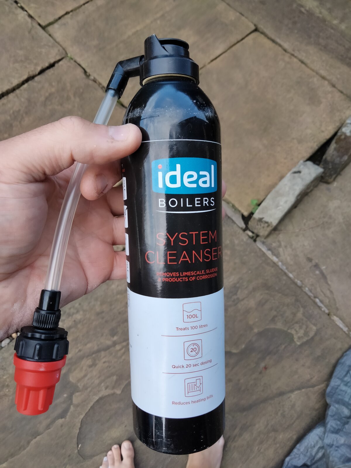

Can this be added to the system via the filling loop without draining? Not use these rapid dose cans before.Thanks.
Yes, it can, although I find it works better if you at least depressurise first
Maybe just drop abit of pressure out of the loop then first? With regards to draining after flushed do I need to fill and drain a few times to get it all out? Or is one drain of the system after treatment ok.
You need to get as much out as possible. Kamco do a neutraliser
