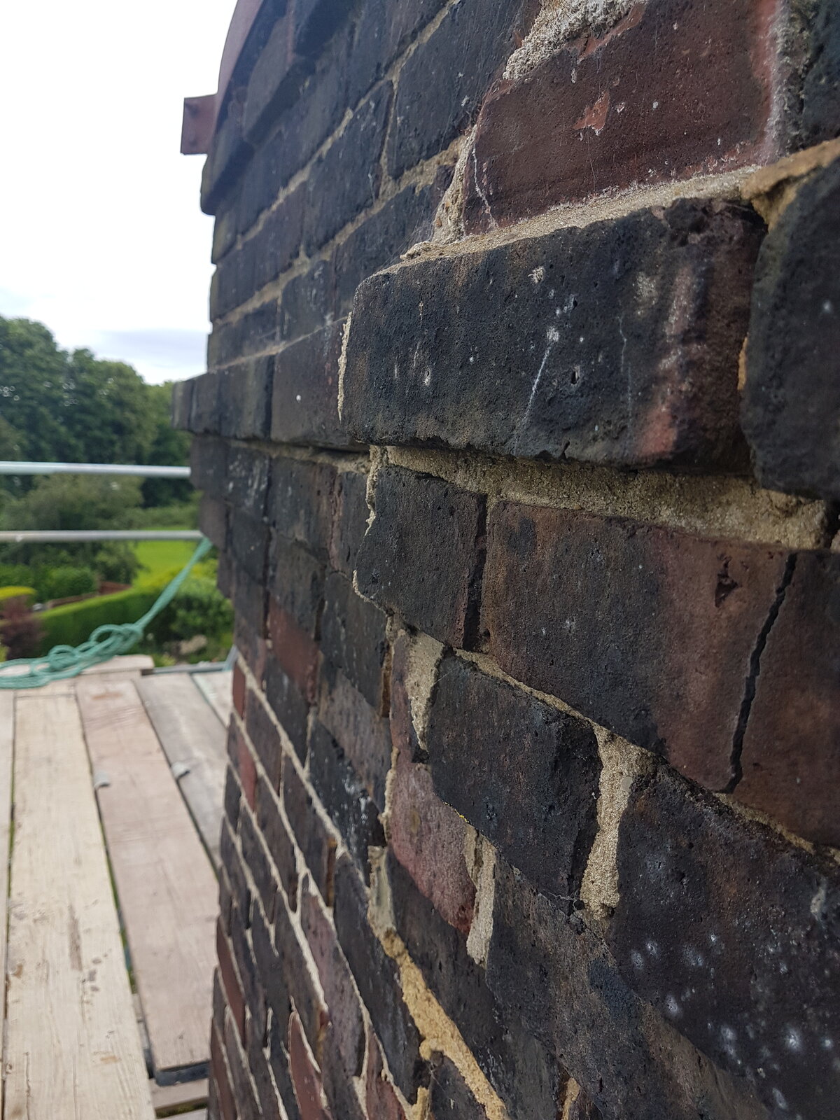

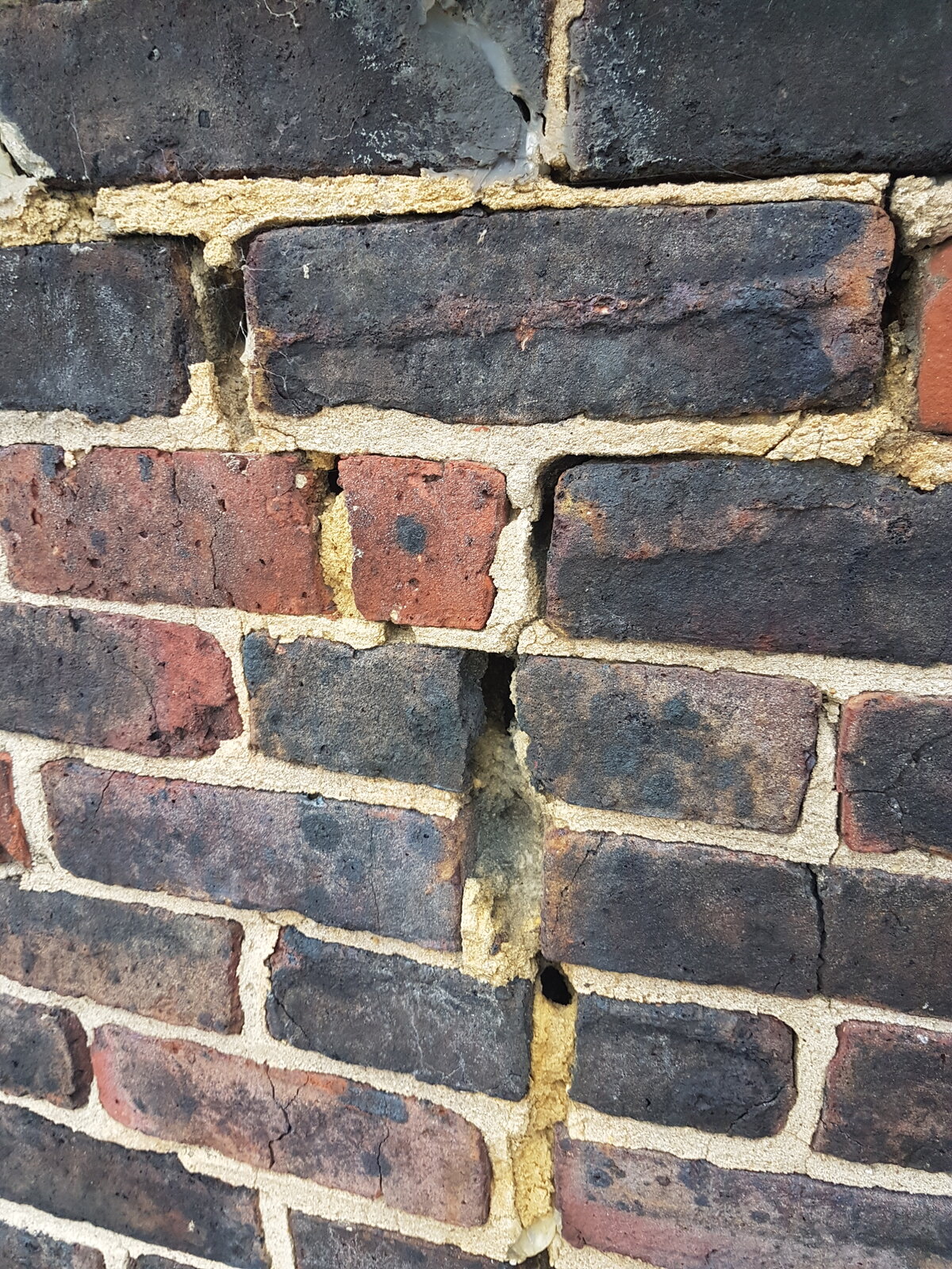

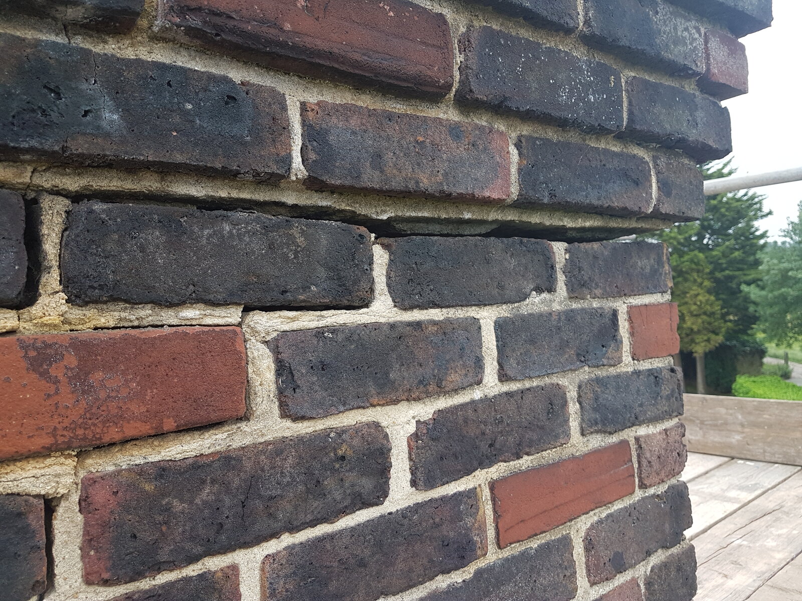

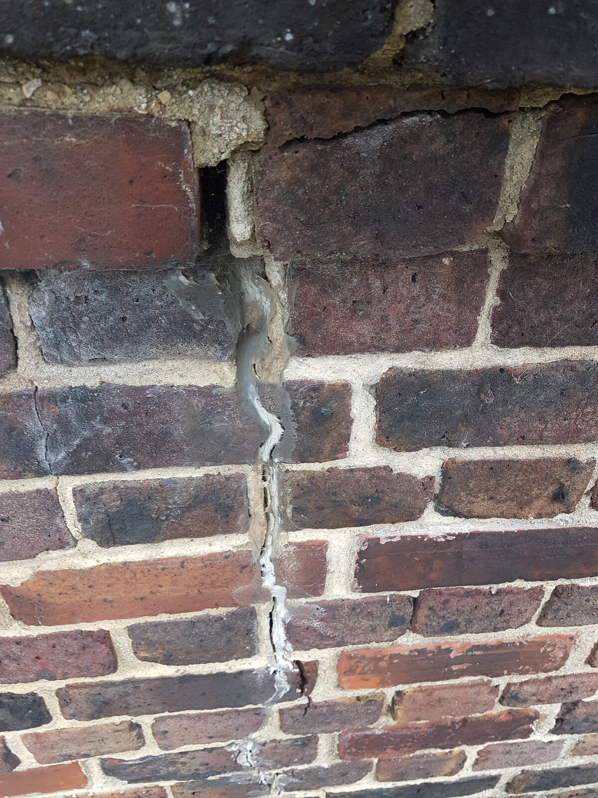

Had the scaffolding go up over the weekend to address the chinmey stack! Looks like its a bit of a mess! Split on both sides. Top section seems to have lifted up from the bit below
comnig out of the line as it moves towards the other.
Would it be best to remove it down to below the crack and rebuild it?
