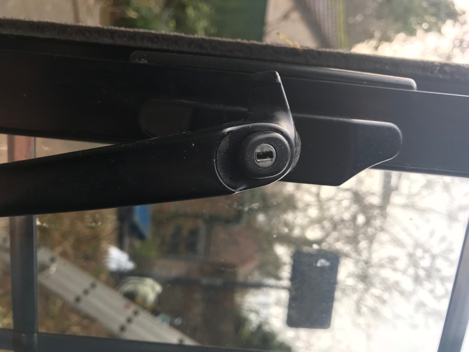

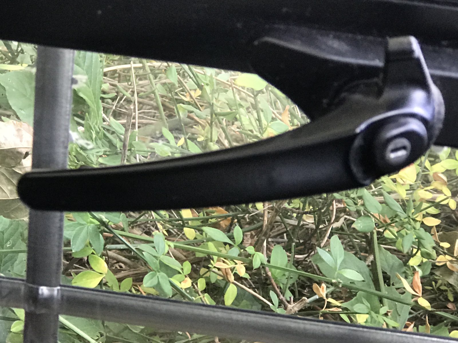

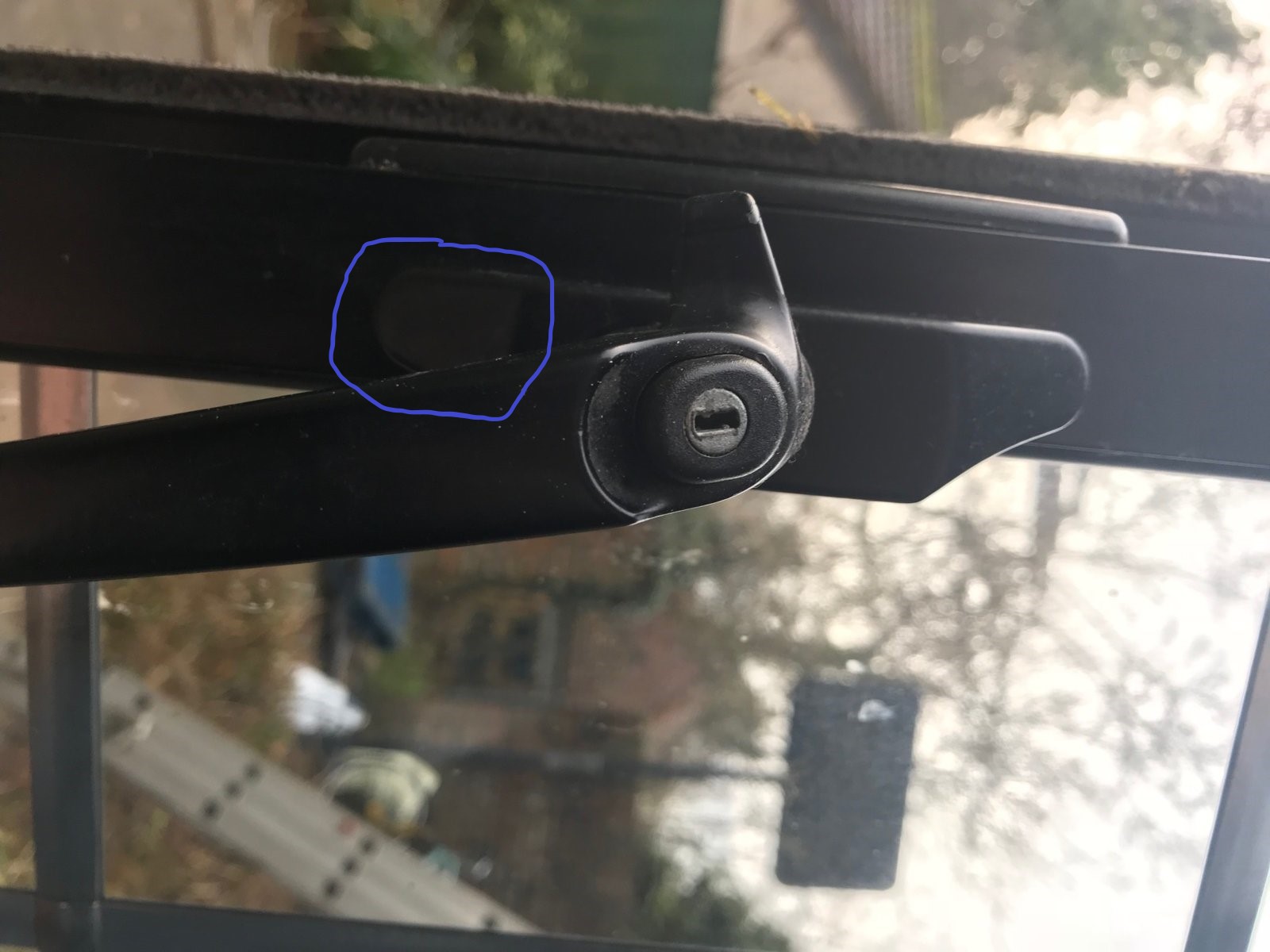

Can anyone advise on how to remove Cockspur type window lock as I have searched the internet / utube for removing lock to refix as screws have come loose

As a rule there is a self coloured plate that is held by clips or double sided tape you flick out with a knife or small screwdriver. The pic is a bit out of focus and in shadow it might just look like a thin moulded line on the handle cover.
No the screws are not visible and unfortunately we have no keys but every window in the house has the same type of locks but some have come loose

many thanks but whilst the picture does appear to show a cover , it actually all one moulded cover with no screw covers?
