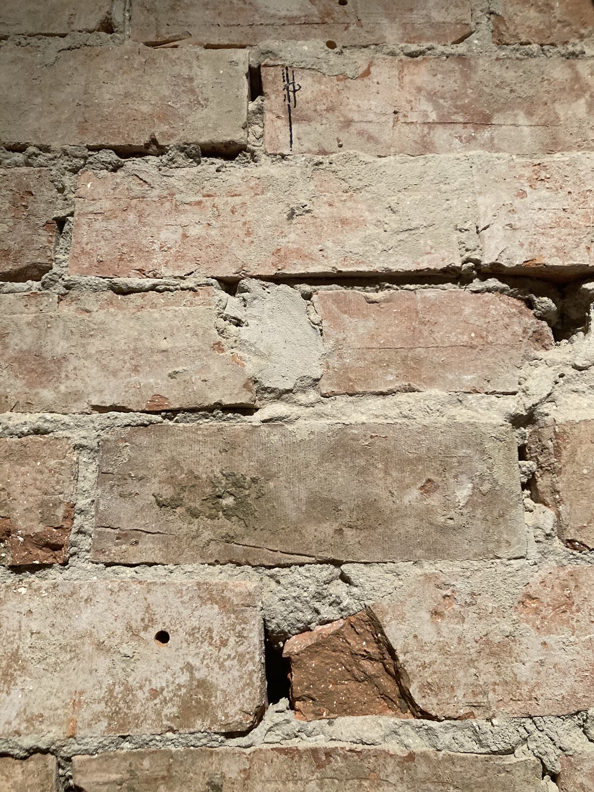

I have a wall that I want to repoint and wanted some advice on the best mixture for it?
The house is a 1900s property; the walls that I want to repoint are Internal and is Load Bearing.
What is the best sand to use for Repointing? Plastering, Shape or Builders?
I wanted to use Hydrated Lime in the mix (with Sand and Cement) I was thinking of a 1:1:5 mix, 1 part Lime, 1 part Cement and 5 parts Sand.
Any advice would be much appreciated, thank you.
Builders sand for mortar. You can add a single part sharp if the gaps are deep to make it a bit stiffer and reduce shrinkage.
I agree with a weak cement:lime mortar.
