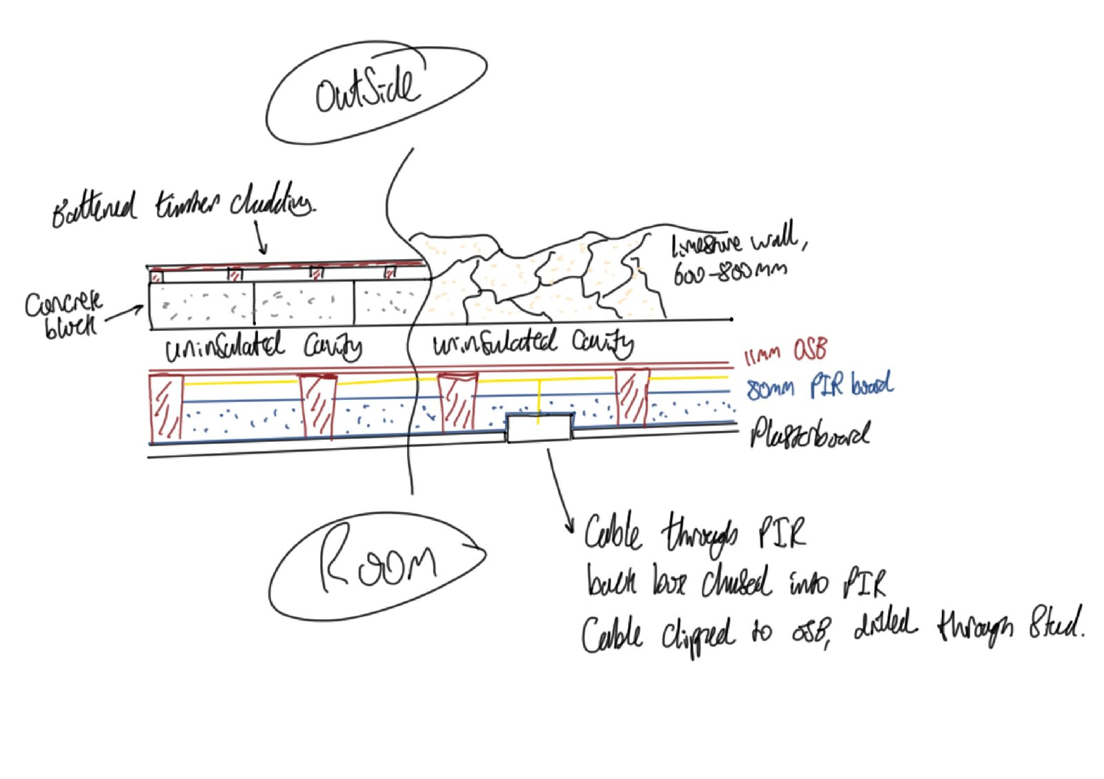

What would be the most appropriate reference method for a cable installed in this manner. The image shows a top down cross section. There is a 20mm service void at the back of a 100mm stud wall (80mm PIR).
Is there a better way to install the cable here?
