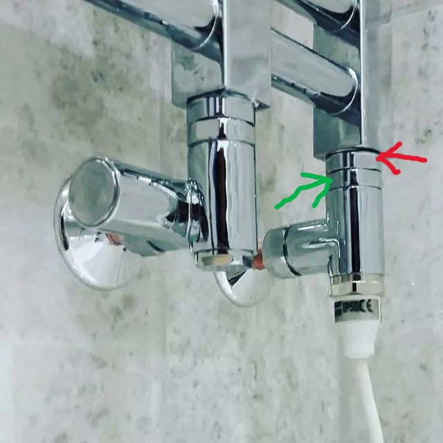

I need to remove towel rail to replace element which has burnt out.
Dual fuel valves are the type shown below.
I'm fine with isolating the radiator, but unsure how to disconnect it from the two valves to drain then lift off. Do I loosen the top collar (red arrow) or middle section (green arrow) ?
Also would be grateful if anyone could recommend the correct type of wrench / grips for this. Seems very narrow - is a spanner best?
Only recently gained the confidence for DIY plumbing - please go easy on me and any help appreciated.

There's only about 100 mm clearance to the floor, so won't get it out or the new one in.
Interestingly, the photo you’ve used agrees with their tech drawing but all their other photos look different.
I believe there is probably both a valve and a tail there. The top nut screws the tail into the radiator, and the bottom nut screws the valve onto the tail. Or something! Hopefully someone who knows more than me will be along soon.
I recommend putting something soft between your spanner and the chrome.
Drain system, undo the third nut on both valves,loosen the brackets and pull the bottom of the radiator forward an inch. Undo brackets and remove rad from wall.

I know, it's weird.
Their photo that I posted, my actual setup looks like that
I was hoping to isolate and drain the individual radiator only. Do you think that's not possible?
