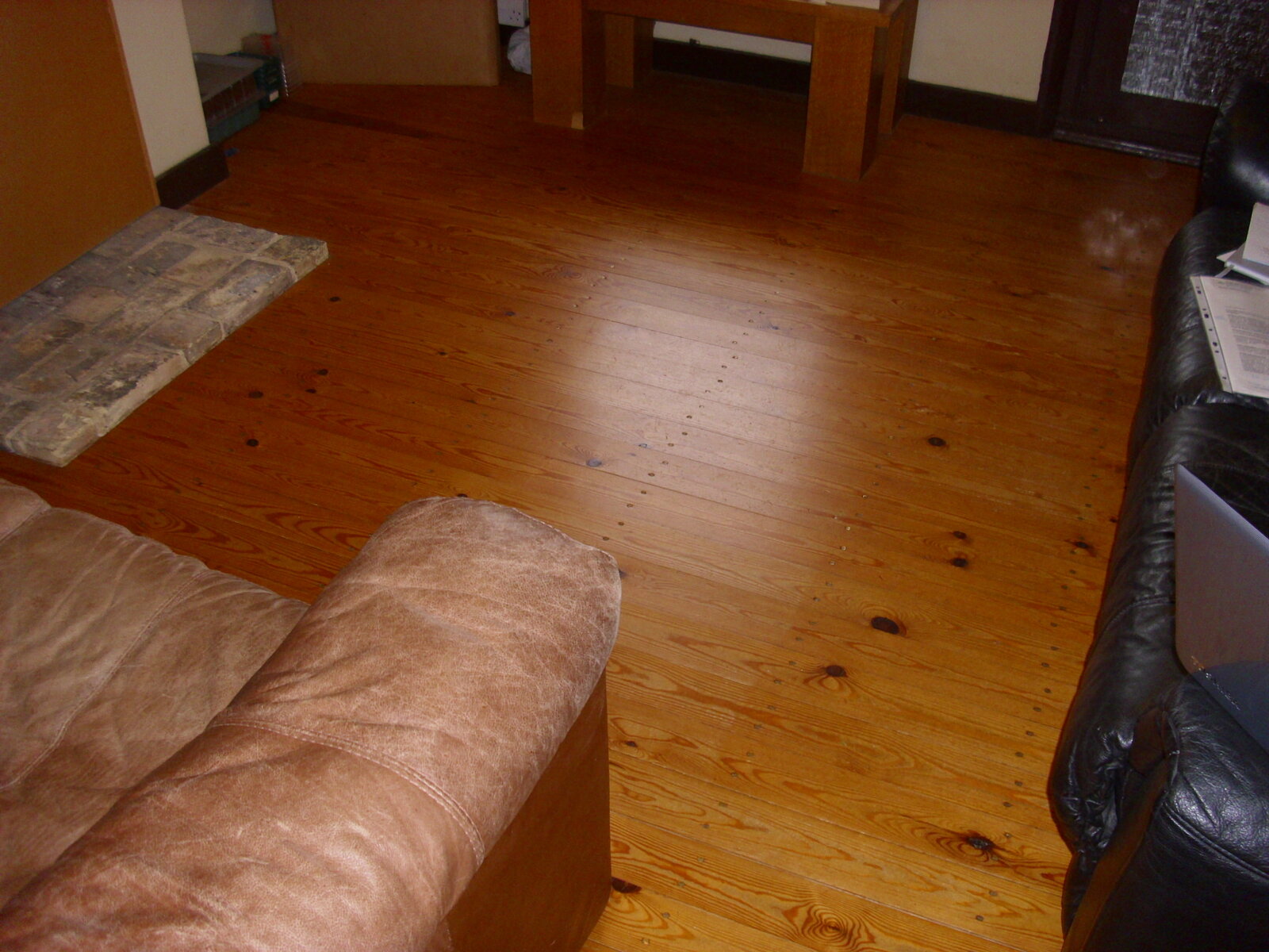

Hmm. I think I'd better show a picture of a part of the floor that hasn't seen much love in two years (maybe six, except the bit in front of the black sofa) as I seem to be giving the wrong impression. As you can clearly see, the floor does not look to be at all dirty and it is only when you really scrub it with a microfibre cloth and see what the cloth is picking up that you see the dirt. So I would not say that what I have attracts dirt and I can also mop it without it seeming to cause any apparent damage. I hope you will understand why I would need a lot of persuading that Osmo would be a better finish.
This is a part of the floor in question. To remove the existing oil, I'd need to sand out the surface because the existing finish would let very little new oil soak in, and I'd need to re-countersink all those screws to sand, so changing the finish is not an option anyway.
So basically, I am 100% happy with the solvent-free linseed oil. I do not use much beeswax polish, so the small amount of turpentine involved seems to be a reasonable compromise. Generally, it is easy to look after, and the maintenance is not excessive. My ONLY issue is the deep-cleaning, and I think, given the technology available, I shouldn't need to have to use my fingers for this task.

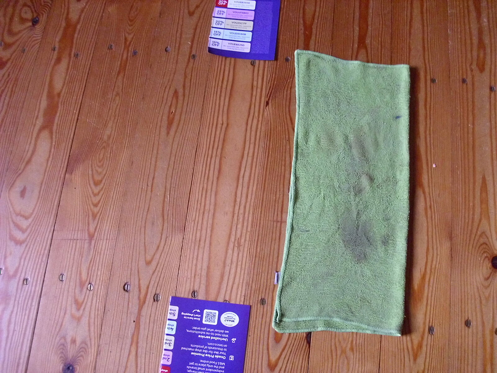

For sake of comparison, I've just scrubbed the area between the two bits of purple paper and shown the dirt picked-up on the cloth (microfibre cloth, wetted with water and very well wrung out). You can see the floor looks significantly cleaner.
If your Osmo floor is also pine, I wonder if you would be interested in comparing? - I would certainly be interested in seeing if there is much difference or not as I am working on a house owned by a member of the family and would want to use the best products there.
Sorry about these photos: the colour match is far off especially in the second one (which the photo shows as pinkish whereas my eyes see it as yellowish); the floor actually looks better than the photos make it appear, but I'm hoping some useful information is conveyed.
It sounds like I'm not offering anything useful to you - I don't think there's a way we can compare the difference between osmo and linseed&beeswax in how they pick up and retain dirt without it being on the same floor with the same use and cleaning regime - I think all we'll learn is that life's too short for me to be scrubbing the floor with microfibre, so any comparison will just show how much less cleaning I do!
I'm not sure I can see a difference in the photo in the board between the purple paper and the boards to the left of it...
