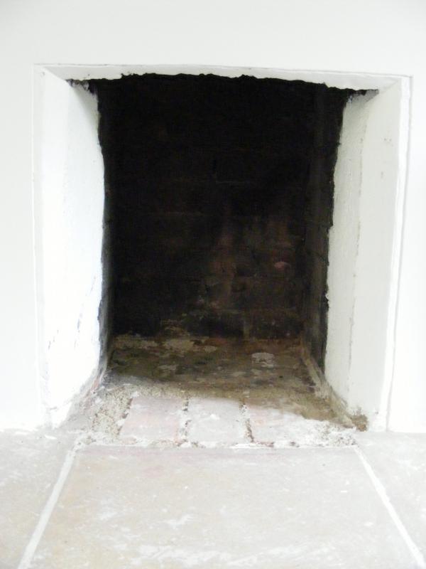

doing a bathroom for a customer at the moment and he's asked me to 'tidy up' his fireplace, he has a grate inside a chimney of brick construction which he uses for open fires and therefore has black sooty brickwork inside the fireplace.
it currently has a beveled frame effect on the front which is a bit of a mess and he wants it making nice and tidy, so questions are:
1) mix of render? is standard 5:1 ok or does it need some lime too?
2) guessing i'll need to clean sooty bricks down with something? sugar soap?
3) how is best to form a nice new bevelled frame? (from face of fireplace 45 degrees back into the fireplace)
4) current render is painted so how best to bond new render to painted stuff?

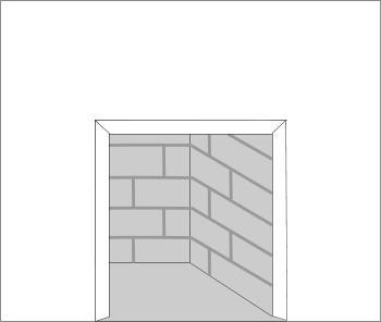

will attempt a diagram to help explain what i mean by 'frame'

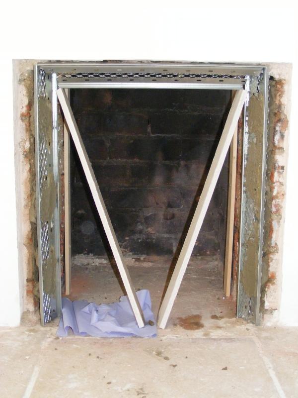

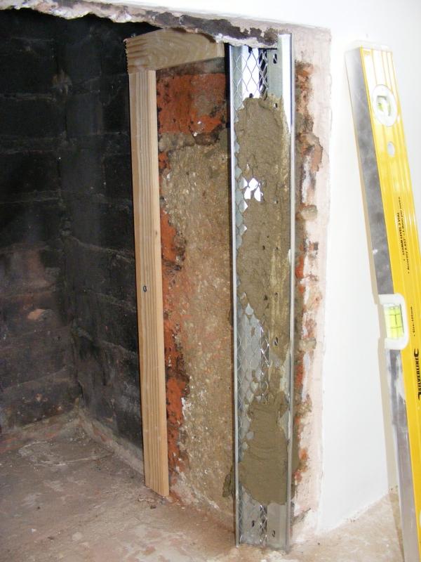

hope this helps RC? all the white in the diagram is painted render, the 45 degree agnles of the fram are currently...RUBBISH and he wants render to go back a little further into fireplace, was thinking of fixing vertical battens halfway inside to render up to and bring it out 10-15mm which should give me room for forming a new beveled frame, just wondered how best to 'hand-form' this with sharp, straight lines...GULP!
Hi TM,
Been looking at your diagram, (any chance of a pic?) and reading your plan of attack., I hope i'm reading you correctly. I like the sound of the thicker batten, deeper into the fireplace to render up to. Can you not use temporary battens front left/right/top, to help give you your sharp straight lines? I understand what you're trying to acheive, and thought working off of the battens inside the fireplace, the beveled frame, and front of the fireplace would give you sharp corners, then re-render the front. This would be done all in one go, returning the wet rendered corners. Tricky to do, but it would look a neat job in the end. You are in effect rendering the inside of the fireplace, the new beveled frame,, and the front of the fireplace,,, all in one go using temporary straightedges to return all the corners. Hope you understand the idea. "Thorough prep" on the front painted render would be one of the main parts of the job, and i would scratch coat "everything" first.

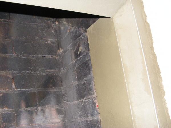

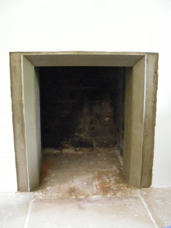

Did that fireplace, couple of pics attached, let me know what you think! left space around the frame on the face for filler and sanding.
Thanks for your help ;-)
That's an extremely good fix - not just a tidy up. That's high class work. Well done.
thanks chaps! :D have to say i'm very pleased with myself over that one, just hope it stays in tact after a few fires...GULP!
i used sand, cement and lime in the mix, nothing else on it at present, it was render to begin with so render is what i've left him with, going to use a filler to fill the face around the frame so that i can sand it off flush and hopefully make it a seamless join with the existing.
