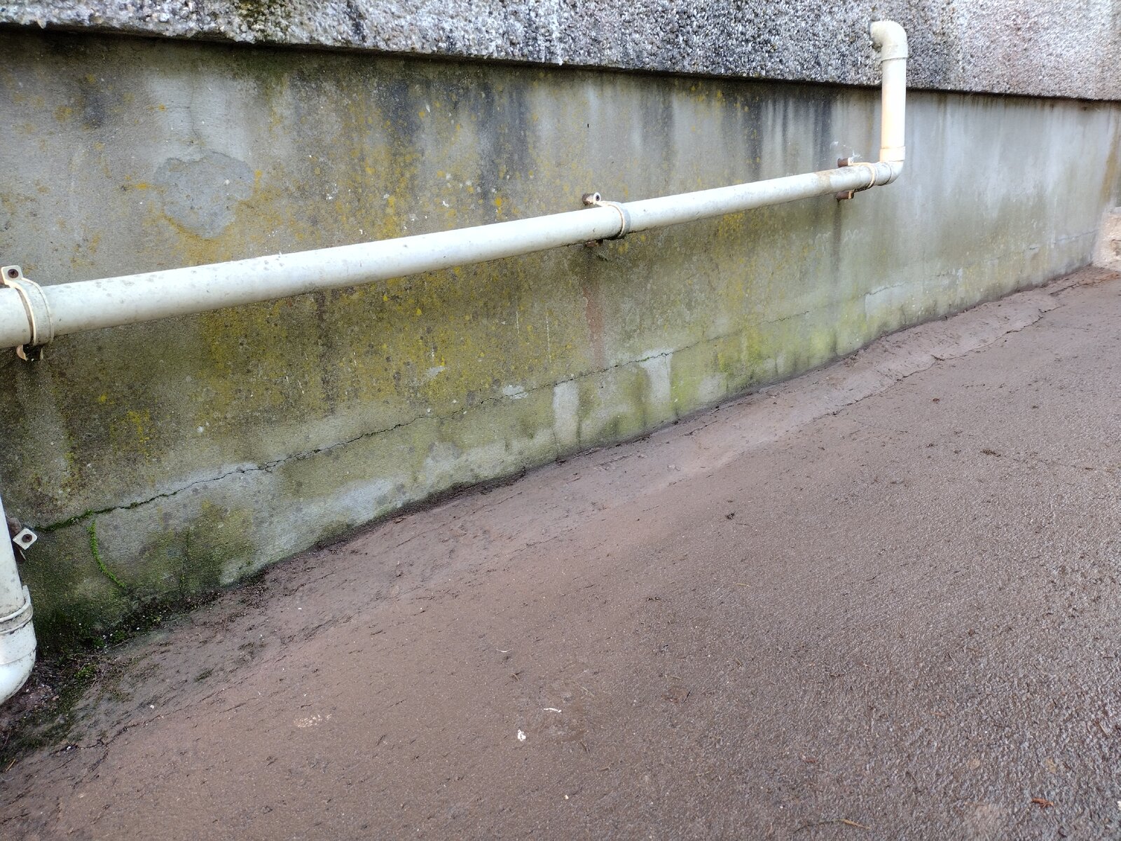

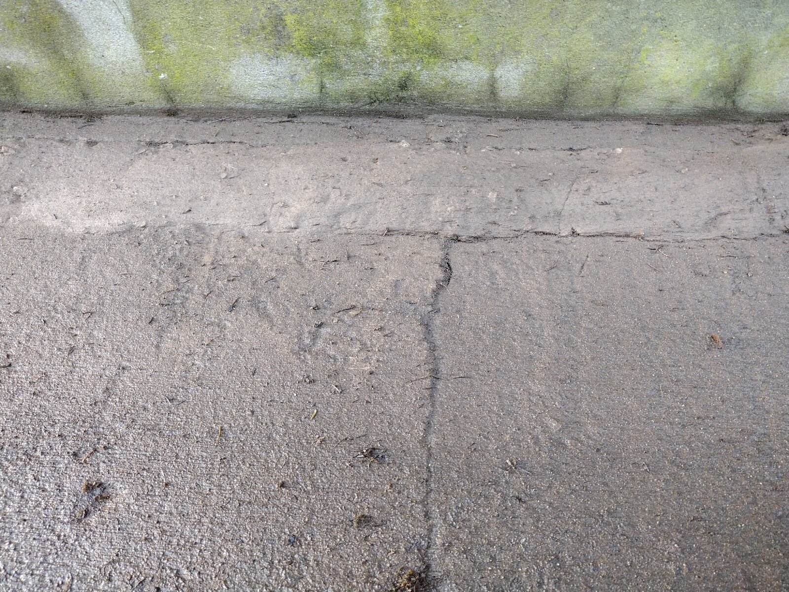

I've found a couple of pics which may help. I'm presuming the long "crack" parallel to/beneath the pipe and extending beyond it is the DPC? What do you think?

Here's those pics. Thanks so much for the help.

I've measured up and the ground level outside is 230mm lower than inside (including the two layers of tiles on the inside, without those it's more like 170-180mm difference).
The DPC (if it is in fact the DPC) is 160mm above ground level.

If nothing else, I was thinking to remove the existing knackered fillet, repair obvious cracks and defects in the ground-wall join with a concrete repair mastic, followed by a new fillet. I figured and hoped that if this worked in the past hopefully it will again.
I've no idea what mix of cement to use, whether to use SBR, etc. - so any thoughts on that would be great.
