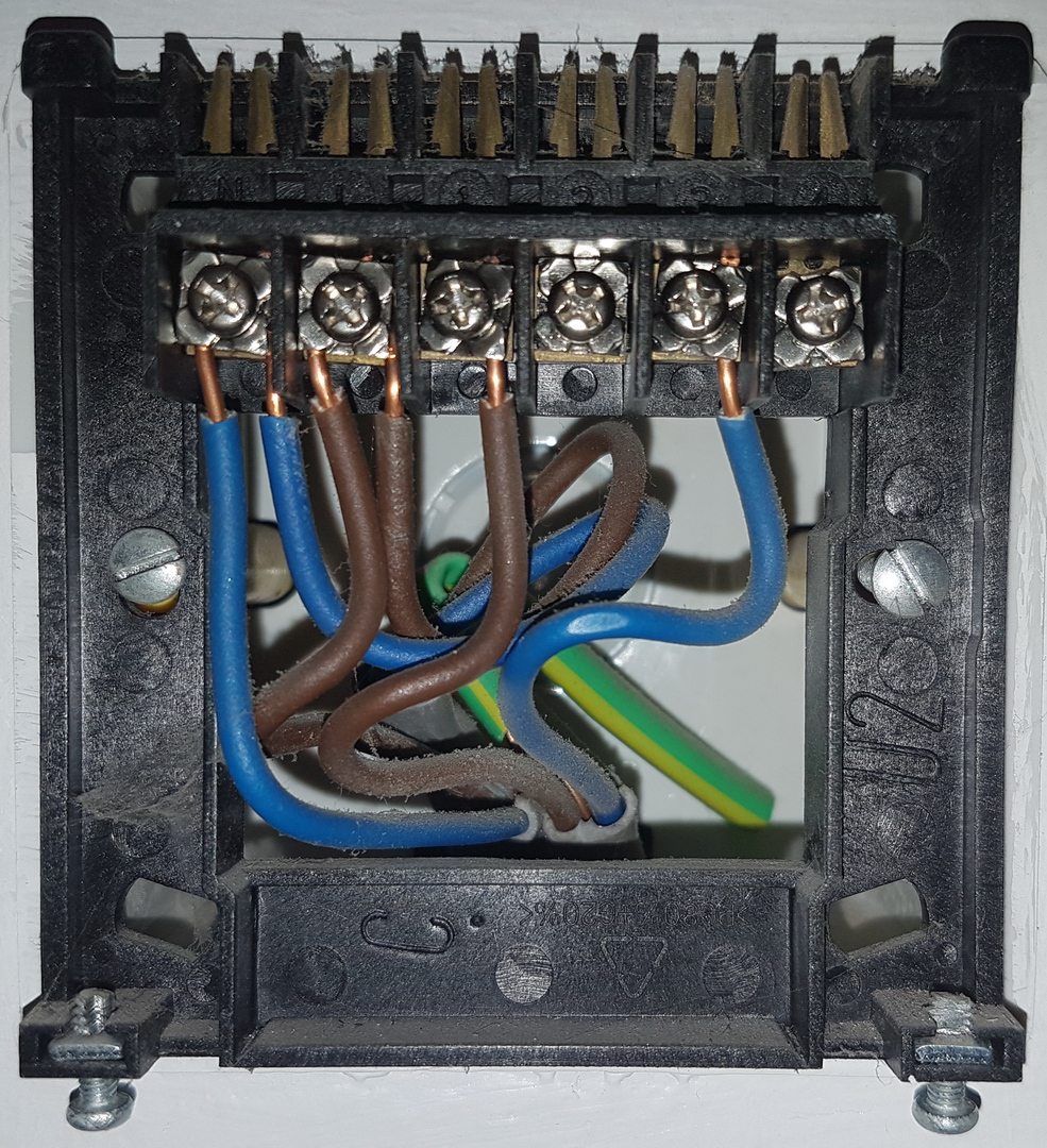

The wiring behind the Sunvic...
First of all the Hive is a programmer / timer, and a thermostat all combined into one unit, (as is Nest and the others) so you will be "introducing a thermostat into the equation"
It is also now part of the building regulations that new systems have a boiler interlock to make them energy efficient and shut the boiler down when no more heat is required. [TRV's don't do this, they shut the radiators down but the boiler keeps on going and wasting fuel]
So back to your question.

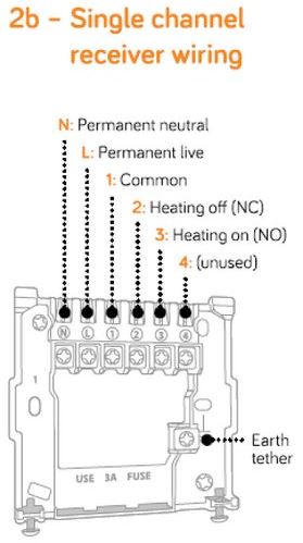

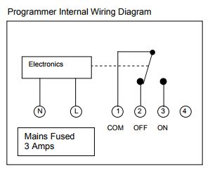

There are different versions of the Sunvic Select, but looking at the wiring in your photo, it would appear to me that yours is as per the model detailed below. These details will be in the installation instructions for it, or printed on the back of it somewhere for you to check and make sure.

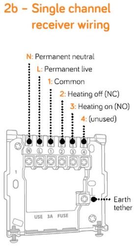

If it is the same as the above, then the Hive Single Channel version will be a straight swap as you can see from the drawing below the connections correspond terminal for terminal.

That first diagram is indeed on the back of the timer (it's a 107XL, now I see the label on the back) although it says fused 6a, rather than 3.
That is the rating of the programmer. the Fused connection unit supplying it and your boiler will have a 3A fuse in it. (Good luck finding a 6A fuse in the UK) The thermostat should be in the last place to warm up. Otherwise it will turn off the entire heating system leaving other rooms cold, so they have to heat up first and the TRVs will stop them overheating.
They are supposed to be universal but can be a bit tight occasionally. The Hive will come with one.
Indeed - I discovered this. The bottom screws on the existing plate weren't long enough to accommodate the Hive's plastics, even with a bit of force. So I ended up fitting the Hive backplate rather than shaving a bit of the Hive Receiver.
