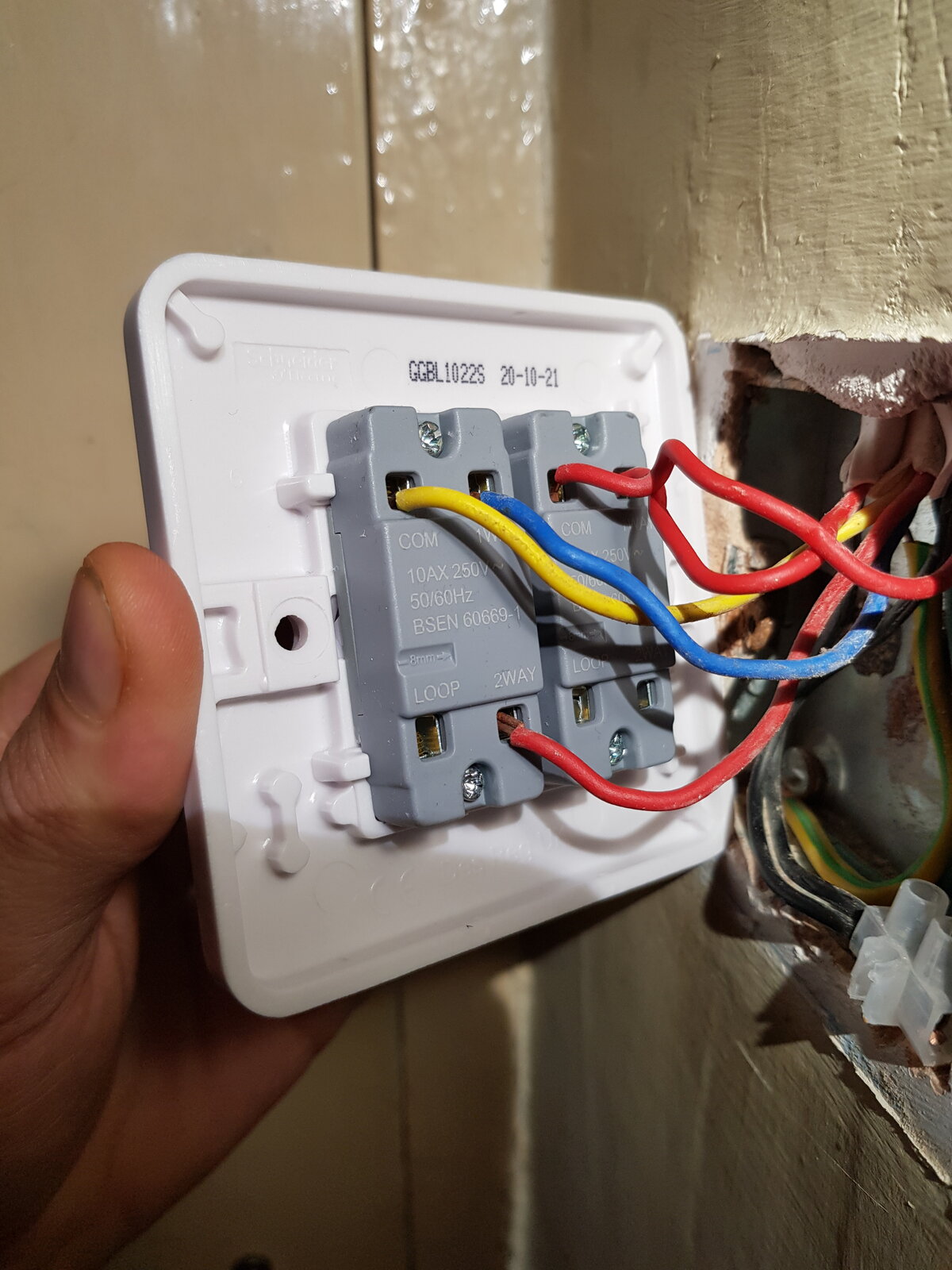

Hi, I replaced an old double light switch, one switch does my porch light, the other should do my lounge lights. It was an old switch with L1 L2 and L3. I followed these instructions when changing it :
L1 . . . . COM
L2 . . . . L1
L3 . . . . L2
And it doesn't work. I have posted a photo, any ideas? The porch light works, but that was just two wires
I've just checked at the back of the switch with a multimeter and I'm getting 240 when switched on. But at either of the wires coming out of the wall to the two light fixtures, I'm getting 2v when switched off, and 3v when switched on!! I have no idea what's going on
