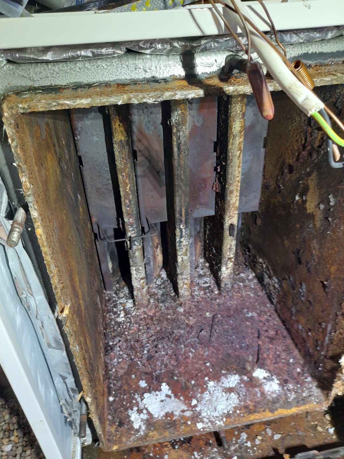

I would strongly recommend that you look at other options that don't begin with a W.
Worcester are not what they were we have replaced a fair number only just out of warranty
Picture attached of a 5 year and 6 weeks old Worcester. It had been correctly installed and serviced at correct intervals.
Worcester in effect told customer to get lost

That is shocking
