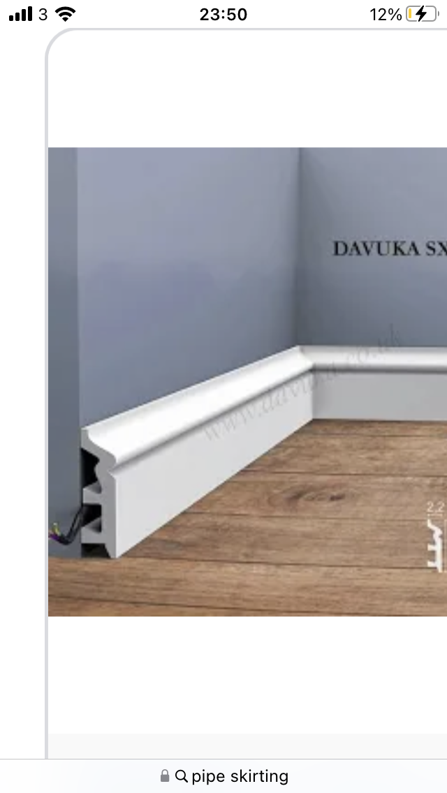

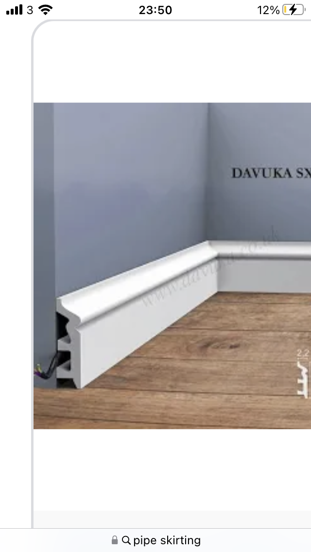

Personally I wouldn’t use 10mm poly, they use it on new builds and it causes more issues then anything. 15mm will give you better flow and is more stable , poly tends to Ben especially the hot water v cold no matter how matter how many clips you have… the best solution would be to find the leak it’s prob from a soldered joint.
If you must surface mount them I’d change the skirting and do it because you wouldn’t be happy surface mounting the pipes it will bug you in the future.
Regards
Jake
