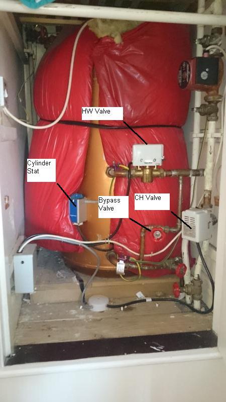

I do know that there is a Grundfos pump in the airing cupboard next to the cylinder and two white boxes connected to the pipes which I believe are motorised valves, but that is the extent of my knowledge - the airing cupboard is a bit of a spaghetti junction or pipes and wheel valves, and I don't really know what any of them do! I just opened them all when I first moved in and hoped for the best, I've never touched them since lol.

Yep like that - they're called 'Lifestyle 2-port motorised valve', there is one underneath the pump on a pipe that doesn't go into the cylinder, and one on a pipe that come off the other pipe and goes into the cylinder about halfway up it.
They've both got what looks like a switch with A - B settings, the one on the pipe running down past the cylinder is set to B, and the one on the pipe running into the cylinder is set to A, someone has also written on this one with a marker pen putting a C next to the A and an O next to the B (presumably meaning open and closed?).
Both the valves, the pump, and the cylinder thermostat have wires coming off them going into another white junction box which then has only 3 wires coming out the other end going underneath the airing cupboard (presumably to the timer downstairs?). Oh and the valve that doesn't go into the cylinder has it's wire going via a smaller round junction box screwed to the bottom of the airing cupboard - not sure if this is just to extend the wire though?
Any chance of a pic showing the two valves etc?. A wide-angle view is better than close ups of each item as then we can see how it all fits together.
Turned and annotated :wink:
The HW valve is controlled by the cylinder stat
The CH valve is controlled by the room stat
The bypass provided a path from flow to return if both valves are closed buit the pump is still running. The manual valve should be replaced by an automatic bypass valve.
As you say, the junction box on the floor is just to extend the cable from CH valve, so it doesn't hang in the air.
You have everything necessary to do what you want, but the wiring in the junction box on the wall needs to be checked, as will the junction box on the floor. Close-up Pics of these boxes (lids off :) ) should do. :)
