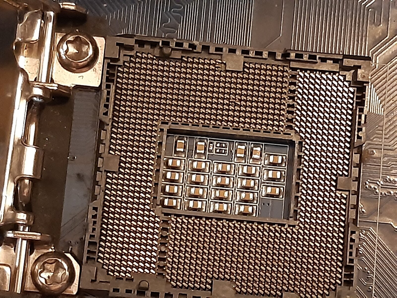

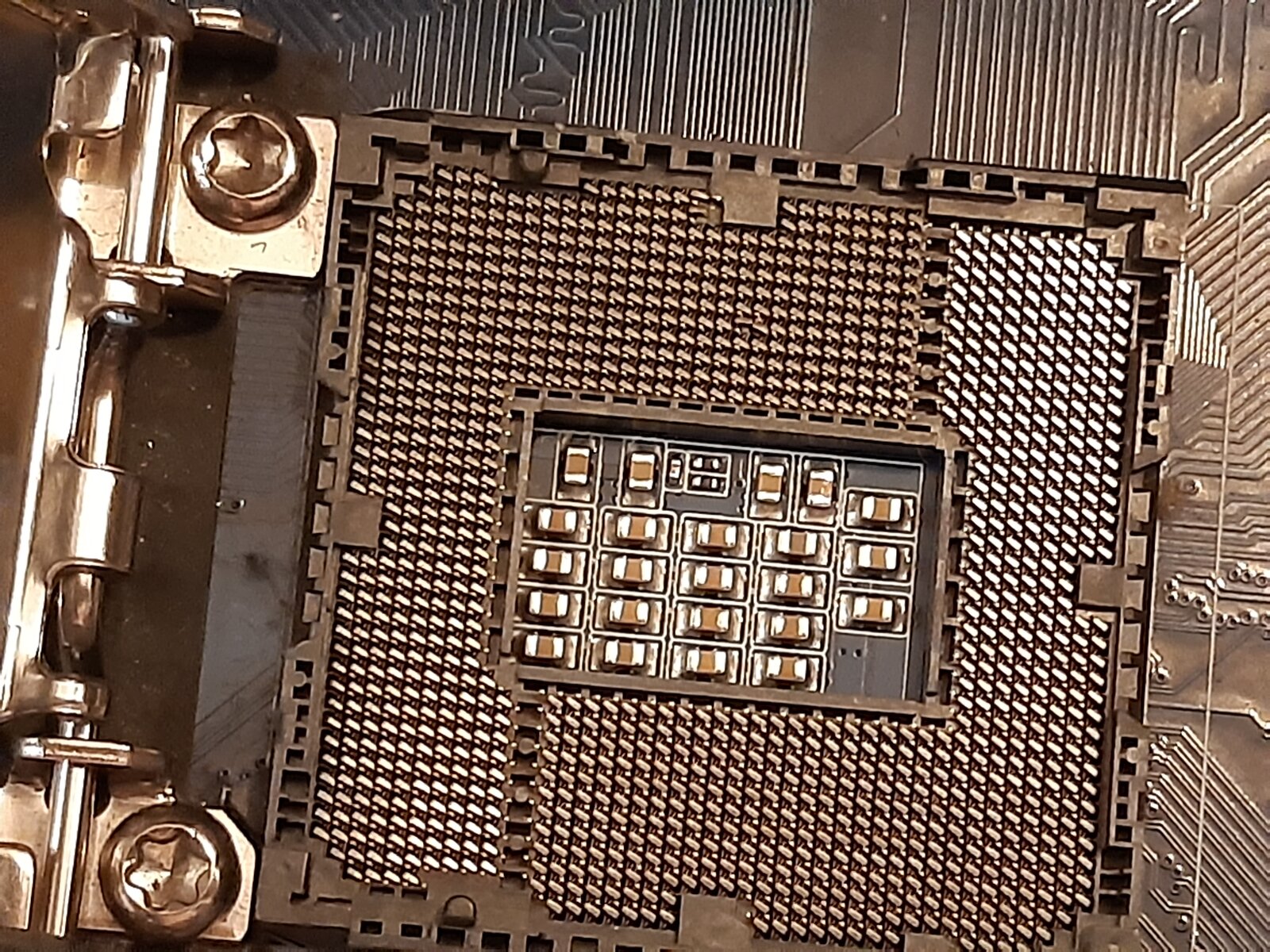

Couldn't help thinking there might be damage to LGA socket. My eyesight struggles.

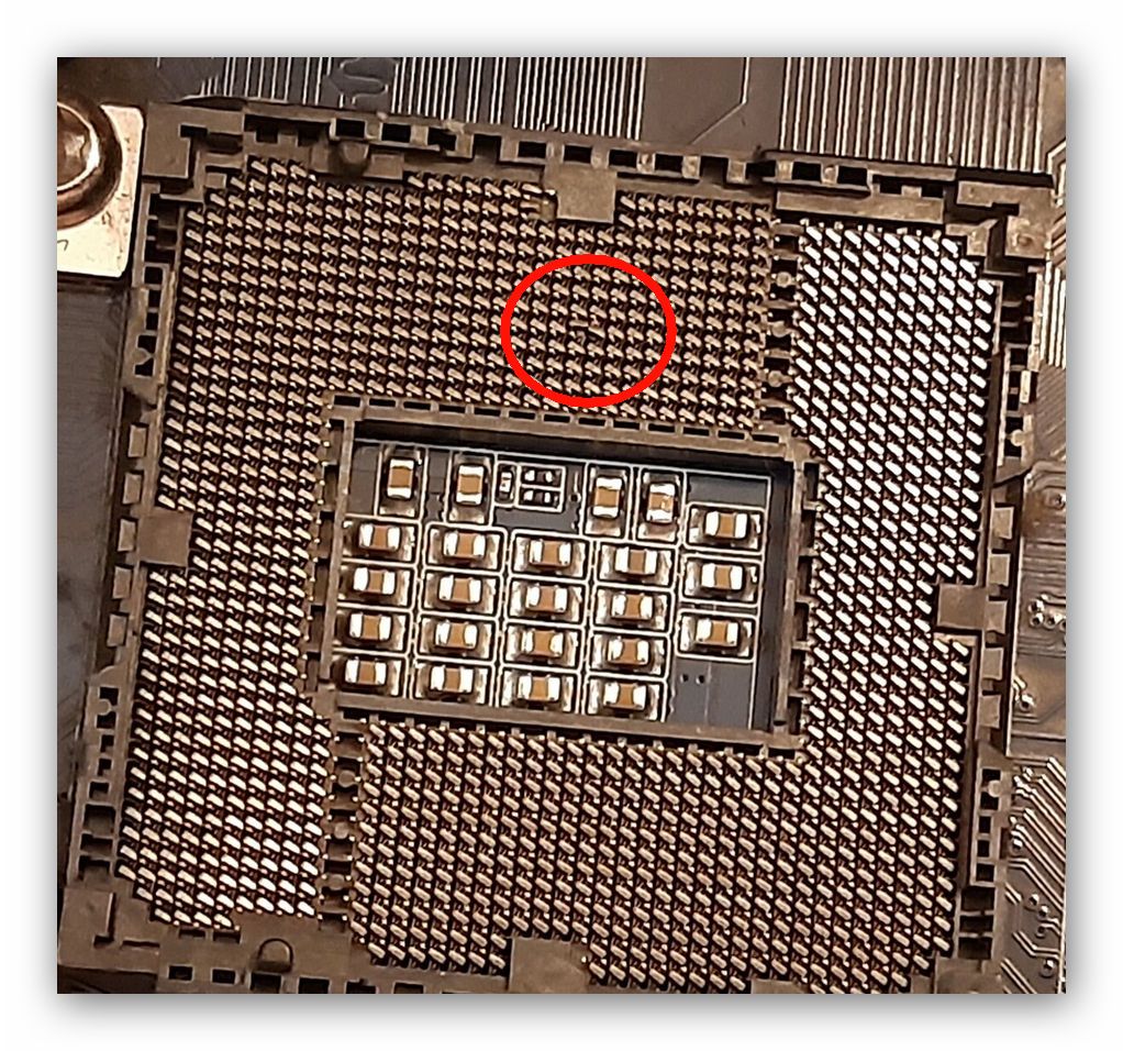

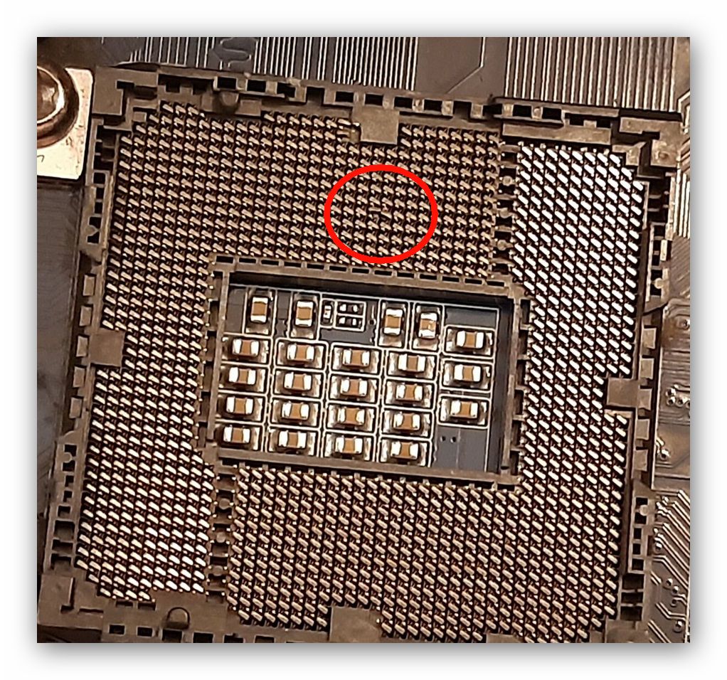

Have you got a couple of bent pins?
