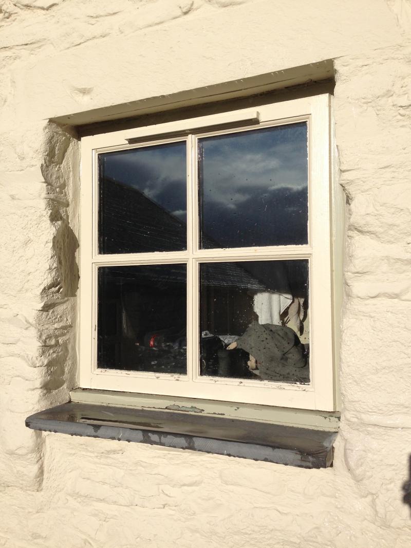

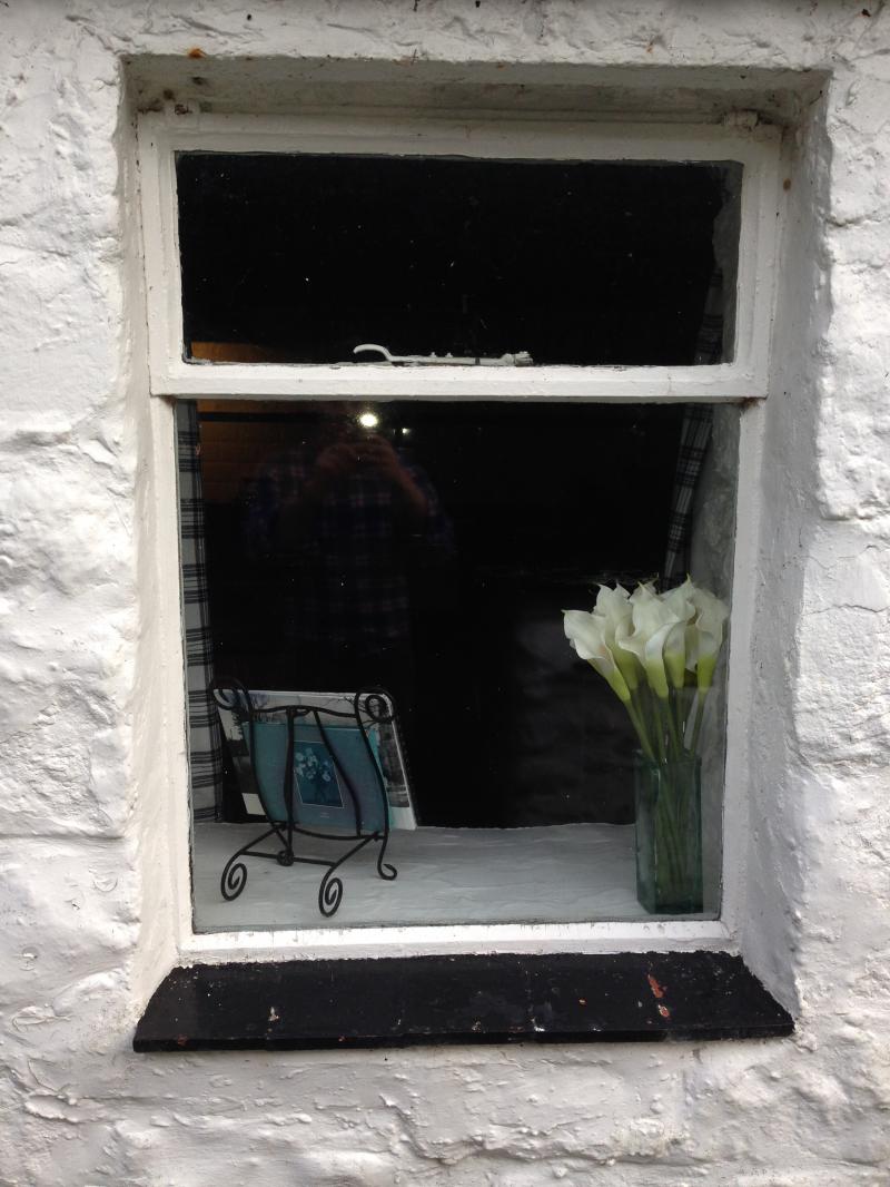

Looking to replace 3 of these windows with some four pane wooden windows.
Never fitted any windows before so am wondering how hard can it be?!
Am I going to regret it once I start? What is the best way to fix windows, if they come pre-glazed? Using fixing straps which will then be plastered over? The stonework on the inside is only rough.
Any suggestions or things I should be aware of?
Probably looking at replacing with something like this:

Besides those old Crittels are rendered right in and are going to be a pig to get out.
Everything Gazman say's may be true, but here's how I used to take out the old and fit the new timber ones.
Remove the opening sash with a crowbar (just lever it against the remaining frame) then cut through one of the sides at a slight downward angle, the bottom part is now free to crowbar in wards, followed by the rest of the frame, it could be described as an implotion in a way. With the old window out its time to insert the new wooden ones, these should have a suitable width of Visqeen DPC stapeled all round the frame. now simply clear the ingos to allow the new frame and visqueen to push up against the window checks, if there are none the frame should be positioned roughly level and plum with long wedges and checked scrupulously with a level, replacing the wedges with square strait packers as required. Between these packers expanding foam should be sqeezed, between ingo and frame to provide a good draght proof seal. Job done ...pinenot :)
