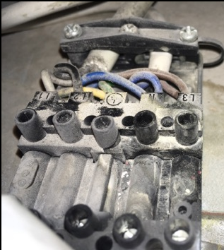

Hello nice people. Im trying to replace my existing Danfoss thermostat with Nest 3rd Gen. Lack of diagram understanding! I really do appreciate if you can give me not only clear answer, but also share how to read these simple diagrams. I really want to understand it.
My Combi Boiler is ideal isar he30 and here is a manual for it: https://www.freeboilermanuals.com/assets/pdf/ideal/203319_inst.pdf Page 32.
Inside boiler wiring. Main supply to thermostat.
Nest thermostat diagram:

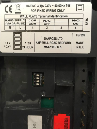

Current thermostat is:
I will be very, very appreciated for your help!

First remove link between what looks like L1 and earth on the boiler plug ? remove Danfoss stat use the live and neutral for the nest, connect com from old stat to 2 on nest and connect 4 from old stat to 3 on nest. old stat to
Thank you, all working good!
