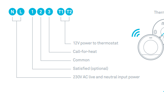

Could any of you give me some guidance on how to replace my Honeywell T6360B thermostat to a Nest thermostat.
I have a Grant Vortex Combi 21e and the current stat is connected via terminal blocks 25 & 26.
I have connected the Live and Neutral via the mains on the Nest Heat Link but I can't seem to get the Heat Link connected using the existing stat wires on the Honeywell stat as the amber light keeps flickering when it should be flickering amber and green.

What I have connected to the Heat Link is live & neutral which is connected via the mains and that's as far as it goes as I can't seem to pin point which cable is the call for heat and common.
Do you know which cables I need to put in terminals 2 & 3 on the Heat Link?
Yes, according to this diagram
25 to 3
26 to 2
Ignore T1 and T2
I've tried connecting the way that diagram shows but for some reason it's not connecting.
Any reasons why this is?
I am using the existing thermostat wires that were connected to my old Honeywell stat if that makes any difference for not connecting to the Heat Link?

finally got it to connect. I had to press down on the Heat Link reset button for 20 seconds for it to connect.
I now have another problem as the Nest thermostat doesn't heat up the boiler when I turn the dial temperature up as if the call for heat doesn't respond to tell the boiler to fire up.
Any suggestions?
