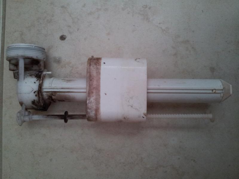

I have a Macdee Duo Compact cistern (installed 2008) which has, for a little while now, had a leaky syphon. It leaks water into the top of the oblong float box and it seems this is stopping it rising high enough.
So the water continues to come into the cistern, whilst making a loud groan, and trickles into the overflow.

Inlet valve or float valve, not syphon.
The inlet valve is either contaminated with debris and needs a clean, or its washer needs replacing.
The current valve is the Wirquin Jollyfill (black), The previous valve was the MacDee Kayla (white).
The TS189 valve is side inlet. Is your cistern side or bottom inlet.
The inlet valve was quite dirty, I removed, cleaned and reinstalled it but no joy.
My cistern is side inlet and the ts189 part looks almost the same.

You could try a new washer, but you'd need to know the exact valve. If it's white like the one you posted a link to it will almost certainly be a Kayla.
If you decide on a new valve get a Fluidmaster inlet valve.
As I said, if you're replacing the valve, forget the rest, fit the best - Fluidmaster.
Had a look at the fluidmaster valves like you suggested - I noticed the one in your picture has a much shorter horizontal pipe (in my cistern the inlet valve is on the far side to the water pipe).
Will this be a problem, do I fit the valve to the longer pipe I have or can I install the valve on the other side of the cistern (nearer the water inlet pipe).
Also I assume that these fluidmaster valves will fit my existing pipe?

in my cistern the inlet valve is on the far side to the water pipe.
Not if it's side inlet it's not.
Remove the bits of the valve you have left attached to the cistern. The pipe through the cistern will be 1/2" (probably) or 3/8" (possibly).
Fluidmaster do both.
Get the right size, it'll fit.

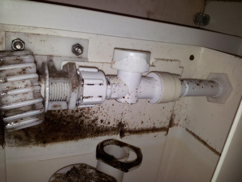

Might be the way mine was installed, but I think I have figured it out.
Looks like my water inlet pipe has been extended into the cistern, I can't get another pic on but the water inlet pipe comes into my cistern from the left, over the flush valve and then there is the inlet valve on the far (right hand) side of the cistern.
Don't know why it is like that, I am guessing that isn't the norm?
I can see the connector that would normally go through the hole in the side of the cistern so I will remove it there and fit a new fluidmaster valve (the one you showed me is in B&Q).
Thanks for your help Charnwood, I will post a quick update once done if I haven't flooded the bathroom..
Managed to upload a pic of my cistern.
The inlet pipe comes from the right (ignore my previous comment, don't know my left from my right).
You can see it coming over the flush valve, and the bit hanging on the left looks to be part of the inlet valve.
The cleaner whiter part looks to be where the new valve needs attaching to. There is a bracket attached to the cistern which seems to hold the horizontal pipe on the inlet valve.
Like I say, don't know why it's like this.. also do you know what the knob on top of the extension pipe would be? A shut off valve perhaps?
Great, that's the nut I was looking at too so I will fit it there.
Also interesting to know about the isolation valve but I will use the mains stopcock just in case.
