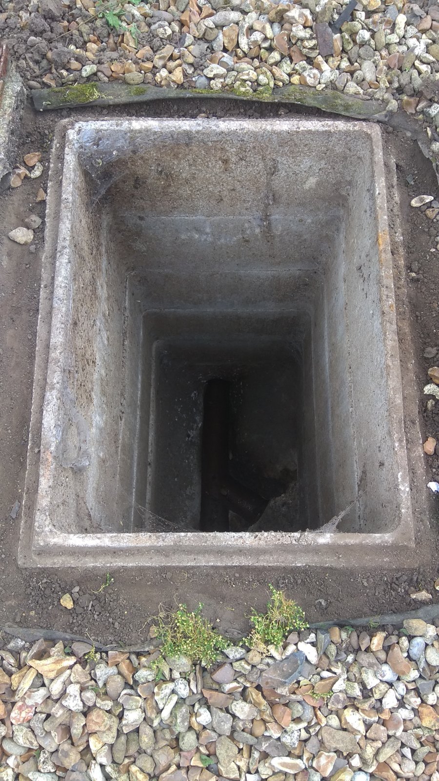

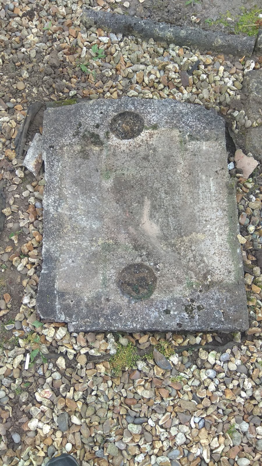

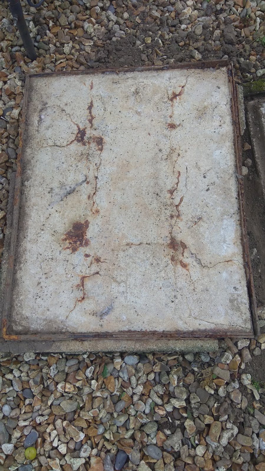

The manhole in the garden is no doubt original from the 60's but the concrete lid in a sorry state. The drain just serves our property so it's our responsibility. The hole wall isn't made up of brick but some kind of prefab concrete insert with a lip on the top for the old concrete lid with metal frame insert to sit on.
The hole is 600 x 450 so can I assume this will be a straight forward task of setting in a new frame with lid on top of the existing hole?

Ian H is your man for this though looking at your pics I think it would be fairly straight forward.
